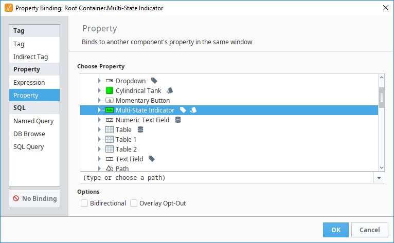

A property can have one of many different types of bindings. Instead of setting a label statically, the text might change based on a PLC value or on-screen selection. There are many ways to bind your components to show values from PLCs, databases, other components, or user input. You can even bind some or all of the properties on each component. You can bind component values using:
  • Property simply binds one property to another. When that property changes, the new value is pushed into the property that the binding is set up on.

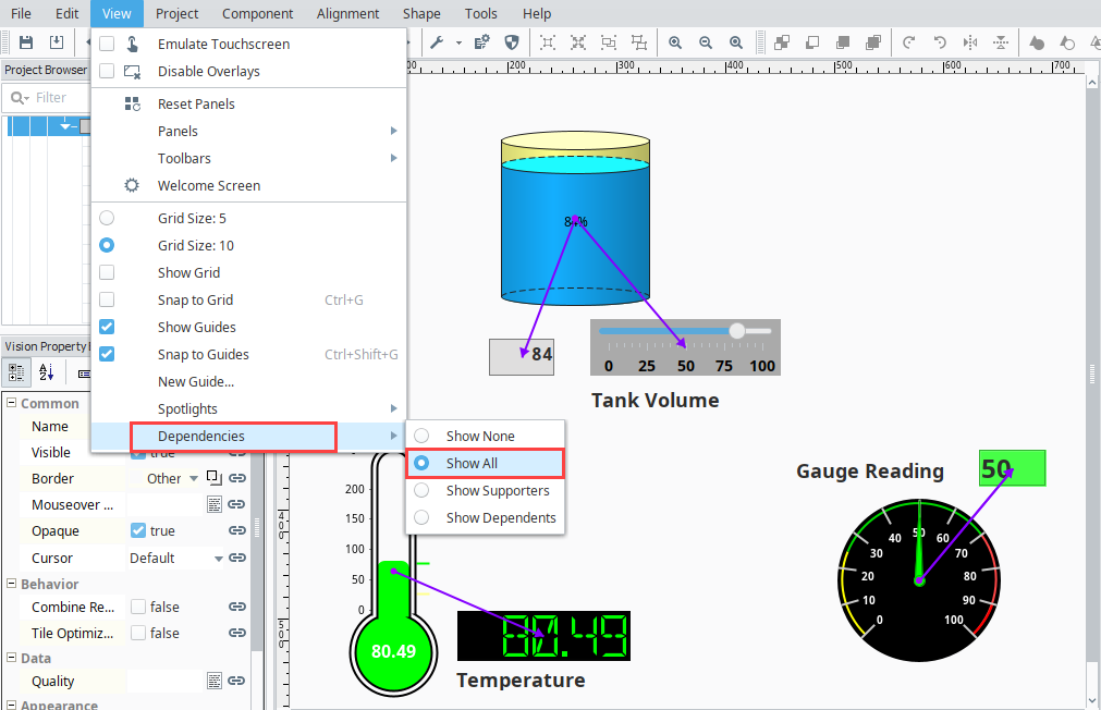

In this image, bindings were set to make these random components do something. You can quickly view dependencies to determine what is linked to what by going to View > Dependencies > Show All. As shown below, a line is drawn from the Tank to the Slider letting you know the Tank is bound to the Slider.

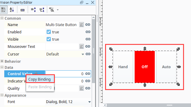

When you copy a component, all bindings, scripts, etc. are copied along with it, but you can also copy a property binding from one property to another. Bindings can be copied from one property to another by right clicking on a property with a binding on it and selecting Copy Binding. Then, on another property, right click and select Paste Binding to paste the binding onto the property. This can be on the same component or a completely different component. The only prerequisite is that both property bindings must use a compatible property type. (For example, a binding that resolves to a string will not work on an integer property.)
