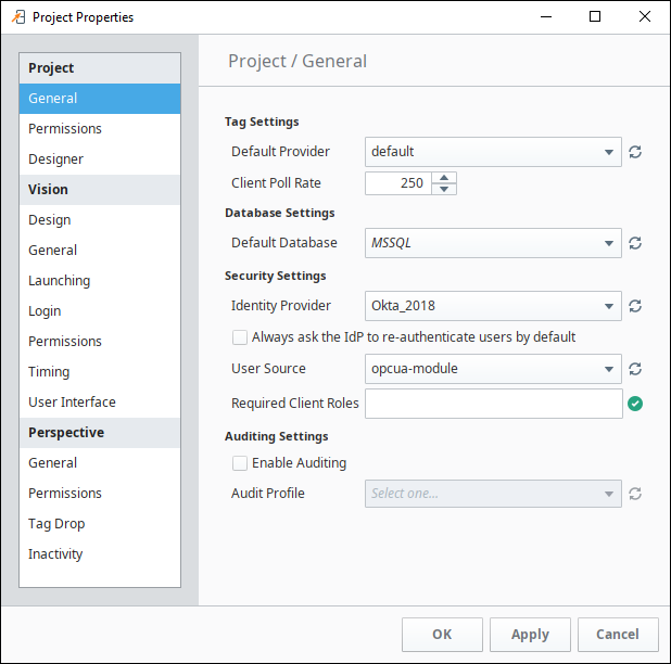

In the Designer, click on Project tab on the menu bar at the top of the Designer, then select Project Properties.
The Project Properties screen is displayed. Project Properties span several functional areas each containing settings applicable to that area.

Default Database and Default Tag Provider
Under Project > General is where you set the project's Default Database and its Default Tag Provider. It is important to understand how to use defaults effectively for proper project design.
Wherever you use a database connection or a Tag in a project, you are always given the option to use the project's default, or an explicitly named connection or provider. If your project is like most typical projects, it primarily uses a single database and a single Tag provider. By consistently using the default option, you make your project more resilient to change.

General Properties
Tag Settings
PropertyDescription
Default ProviderThe Tag provider chosen here will act as the project's default Tag provider.
Client Poll RateThe Client poll rate (in milliseconds) is the rate at which a Vision Client or Ignition Designer polls the Gateway for updates to its subscribed Tags.
Database Settings
PropertyDescription
Default DatabaseThis is the default database connection to use for this project. To use the default database connection, use the special <default> connection, or in scripting, the empty-string connection "".
Security Settings
PropertyDescription
Identity ProviderThe default Identity Provider (IdP) for this project. Choose from a dropdown list of IdPs. You can also choose <None> if the project already had an IdP but you want to remove it.
Note: If your Identify Provider was set in an Ignition version prior to 8.0.6, this property may be located in Project Properties > Perspective General instead.
Always ask the IdP to re-authenticate users by defaultWhen enabled, authenticated uses will always need to re-enter their credentials on login. When false, if a user is already authenticated, then they will not be required to re-type their credentials when an action in the session triggers a login (such as a call to system.perspective.login).
Note: Allowing re-authentication is entirely determined by the Identity Provider. This setting simply makes the Gateway send the re-authentication request. Consult your Identity Provider's documentation for information on re-authentication support.
Automatically redirect users to the IdP if authentication is required
New in 8.1.8
If enabled, users will be automatically redirected to the IdP for authentication if the user is not yet authenticated and authentication is required. If disabled, users will be shown a "speed bump" page, with a message explaining how authentication is required and a button allowing the user to redirect to the IdP for authentication.
Note: This setting only applies to Perspective Sessions.
User SourceChoose the User Source that governs this project's security: specifically, which group of users (User Sources) is allowed to log into the client. The User Sources are all defined in Gateway's Config section under the Security > User, Roles page.
Note: This is for Vision projects only.
Required Client RolesThis property is for Client logins, and determines what role(s) a user must have before they can log into the Client. You can optionally specify a list of roles that are required for a user to log into this project. Use commas to separate the roles. Users must have at least one of the roles in order to log in. If no roles are specified, the user only needs to correctly authenticate with the User Source in order to log in. To define the roles, go to the Gateway's Config section under the Security > User, Roles page. Click the manage users link, and then go to the Roles tab. See also Security.
Audit Settings
PropertyDescription
Enable AuditingIf auditing is enabled, audit events that relate to this project will be stored in the chosen audit profile.
Audit ProfileThe audit profile stores the audit events when auditing is enabled.
