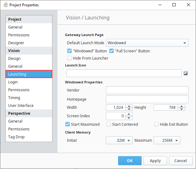

Vision Launching Properties​
These properties affect the Vision Client's launching process.
Gateway Launch Page​
PropertyDescription
Default Launch ModeDetermines the mode for a Client launched from the Launch button that appears next to the project in the Client Launcher. Available modes are Windowed or Full Screen.
Windowed Button/Full Screen ButtonEach launch mode can also be enabled individually, which allows that mode to appear in the Dropdown list next to the Launch button on the Gateway Home page.
Changed in 8.1.13
These settings were removed in 8.1.13. The Window Modes settings on applications in the Vision Client Launcher provide similar functionality.
Hide From LauncherThis option hides the project from the Client Launcher and prevents the project from being selected in the Vision Client Launcher.
Launch Icon​
PropertyDescription
Launch IconThe image specified here is used to represent the project on the launch page and desktop shortcut. This needs to be a path to an image that has been uploaded to the Gateway. Use the browse button to choose or upload a new image.
New in 8.1.12
Supported image formats now include PNG, SVG, GIF, and JPEG files.
Windowed Properties​
PropertyDescription
VendorThis property is displayed as the project is launching through Java Web Start, as well as in the JWS application manager.
HomepageA URL that is displayed in the JWS application manager.
WidthThe width of the Client window when launched in Windowed mode.
HeightThe height of the Client window when launched in Windowed mode.
Screen IndexThe number here is the index of the screen to use for Full Screen mode, it starts at 0. This property is not supported on all operating systems.
Start MaximizedIf the box is selected, when the Client is launched in Windowed mode, it starts maximized. Note that this is not the same thing as Full Screen mode, which is only available when the Client is launched in Full Screen mode. In Full Screen mode, the width, height, and start maximized properties have no effect. When launched in Full Screen mode, the user is given an Exit button on the login screen by default. For terminals where the application should not be exited, this button can be removed by checking the Hide Exit Button box.
Start CenteredIf the box is selected, when the Client is launched in Windowed mode, it starts centered. This property is ignored if Start Maximized is enabled.
Hide Exit ButtonIf the box is selected, when the Client is launched in Full Screen mode, the exit button is hidden to prevent the application from closing.
Client Memory​
PropertyDescription
InitialGoverns how the Client uses RAM resources on its host machine. The initial memory setting is how much memory the Client will require on startup. While this is typically left alone, boosting it a bit can improve performance somewhat.
MaximumGoverns how the Client uses RAM resources on its host machine. The maximum memory setting sets a cap on how much memory the Java VM is allowed to use. When you launch a Client on a machine with plenty of RAM, you'll also need to boost this setting to allow the Client to use more RAM.
