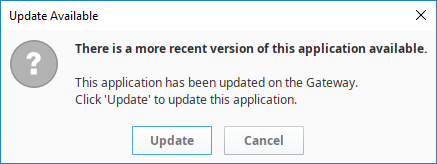

Now, in the Client (with Update Mode set to Notify), the operator will have to click the banner to update the Client.
Then, the operator must click Update on the confirmation message.
Now the client version is updated with the most recent version of the application.
