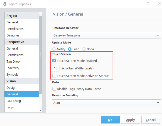

Touch screen support is built into Ignition. Turn it on through the Project Properties or scripting in the Designer.
  1. From the Project Browser, click on the Project Properties icon, or from the menubar go to Project > Project Properties. The Project Properties window is displayed.
  2. Scroll down to Vision > General page, to see the Touch Screen options.
    • Touch Screen Mode Enabled: By default, this is enabled, which means an operator can activate the mode on the Startup screen. All Clients can operate in touch screen mode. When Touch Screen mode is enabled, clicking on numeric and text entry boxes will pop up on-screen keyboards that can be used for data entry. You can optionally set the width of any scrollbars (number of pixels wide/tall)
    • Touch Screen Mode Active on Startup: This option sets the Clients to start up with the Touch Screen mode active.
  3. Change the settings as desired then click OK.
