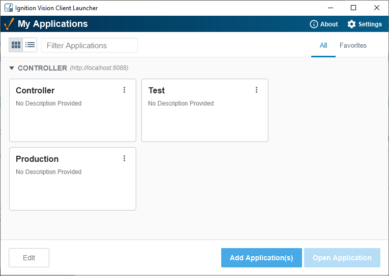

The Vision Client Launcher opens Vision Clients from an Ignition Gateway. Once your Vision projects are added to the Vision Client Launcher, they will be displayed under My Applications and organized by Gateway. This page describes the unique Vision Client Launcher settings, deploying the launcher, and Command Line Arguments.
The Vision Client Launcher is available on the Home section of the Gateway Webpage. More information on installing any of the Launchers can be found on the Launchers and Workstation page. For information on accessing Vision projects remotely, refer to the Accessing Projects Remotely section.

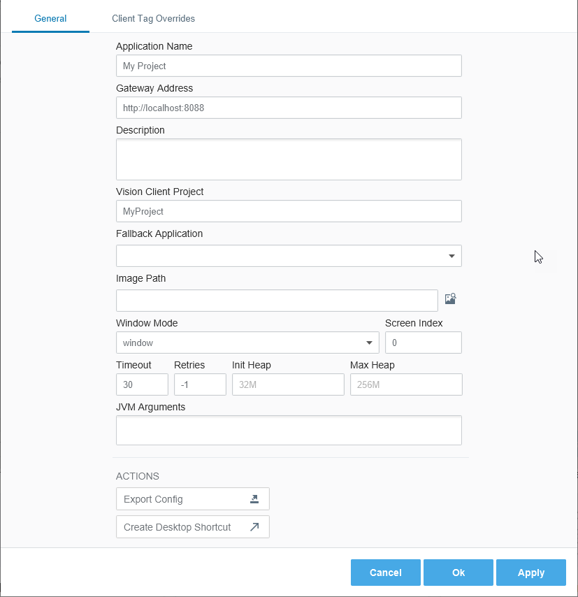

This section details settings for applications in the Vision Client Launcher. To access the settings, click on the three menu dots on the My Applications window and select the Manage option. The General tab will open. The table below shows the General settings that can be applied to each designer.
Vision Client Launcher Application Settings​
Setting NameDescription
Application NameThe descriptive name of the application. This is independent of the project name that corresponds to a project on the gateway. Instead, this is the name of the application as it is defined in the Launcher.
Gateway AddressThe address to the Gateway in the format http[s]://host:port
DescriptionAn optional description for the application that will be listed on the Application in the launcher. Defaults to the Project's description.
Vision Client ProjectThe name of the project containing Vision resources that the Application will attempt to launch.
New in 8.1.5
As of 8.1.5 the Vision Client Project field is required.
Fallback ApplicationThe name of the application (configured in the same launcher) to use if the number of retries has been exceeded. The fallback is only utilized if the Retries setting is greater than 0.
Image PathThis will allow the icon of the application to be set within the designer and it will be downloaded and displayed as the icon for the application as well as the shortcuts. If no path is set, the default icon is used. If this is set to a different icon path, that icon will be used. The image path notation is a filepath on the local system.
New in 8.1.5
Supported image formats now include PNG, SVG, GIF, and JPEG files.
Window ModeControls the Client mode. Available options are:
  • window: Launches the Client in Windowed Mode
  • fullscreen: Launches the Client in Fullscreen Mode
Screen IndexThe screen index indicates which monitor to use.
TimeoutThe maximum number of seconds to allow for any Gateway communication. Any communication that exceeds this amount will cause the Vision Client Launcher to abort the communication and try again if configured.
RetriesHow many times to attempt to contact a Gateway again if an error occurred during communication. Available values are:
  • -1 : Retry indefinitely, or until the Launcher is manually closed.
  • 0 : Zero retries, or abort after the first failure.
  • 1 (or more): Determines the number of retries: i.e., a value of 5 means five retries. If the number of retries is exceeded, then the Launcher will attempt to launch the Fallback Application.
Init HeapThe initial heap memory size for the Client.
Max HeapThe maximum heap memory size for the Client.
JVM ArgumentsArguments to append to Client startup. These should start with a -D and be separated by semi-colons.

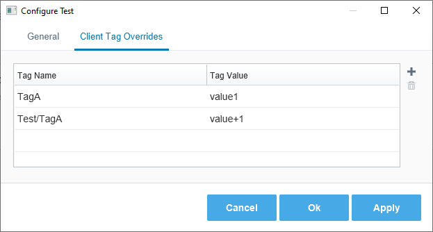

Click on the Client Tag Overrides tab to create or update any tags. The table below shows the Client Tag Override setting that can be applied to each Designer.
Client Tag OverridesAllows Client tags to be overridden on the Vision Client. These are set using the table on the application configuration screen by adding rows with the names of the tags and the corresponding values.
When applying the overrides from command line, the tags must first be defined as launch parameters, then a value can be set on the parameters.
Vision Client Tag overrides within folders and passing Client tag overrides are supported by using a '+' icon as an escape character. This happens automatically if you are configuring overrides in the Client Launcher. To learn more about how to configure Client Tag Overrides, refer to Overriding Vision Client Tags.
