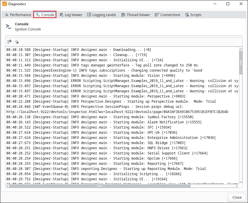

Console Tab​
The Console tab displays the Ignition Console. This console displays messages that are generated by the entity that the console was launched from, such as the Designer. Any print statements or errors in your scripts will show up here (except Gateway scope scripts).
