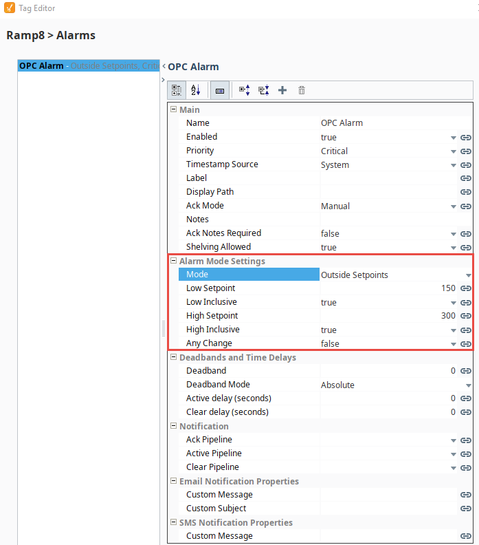

The image below shows an alarm configured on an OPC tag. You can see that an alarm has quite a few properties including alarm mode settings where you can set specific alarm attribute values.

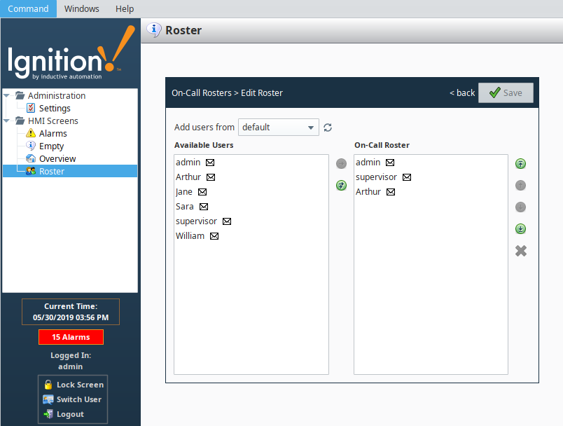

On-Call Rosters​
The On-Call Roster is a collection of users that are notified when an alarm occurs. When an alarm is triggered, a notification is sent to a designated On-Call Roster where it evaluates the users schedules, and only notifies those users that have an active schedule.
Roster Management from the Vision Client Window
