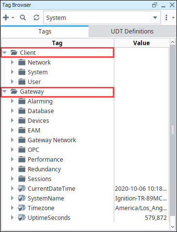

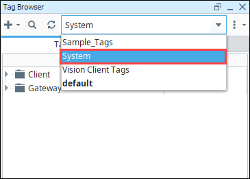

Watch the videoSystem Tags provide status about the Ignition system, such as memory usage, performance metrics, and so on. System Tags cannot be deleted or modified. To view the System Tags in the Tag Browser, go to the Tag Provider Selector and select System.
The System Tags folders are displayed: Client and Gateway. The scope for each is slightly different.

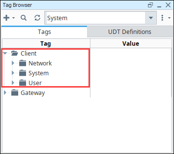

System Client Tags (Vision Only)β
Client-scoped System Tags provide status information about the client's system. They can be used with the Vision module for any Vision Client. Every individual client is going to have their own values, such as IP address, host name, username, and more. There are three folders within the System > Client folder: Network, System, and User. You cannot modify Client System Tags.
Vision System Client Tagsβ

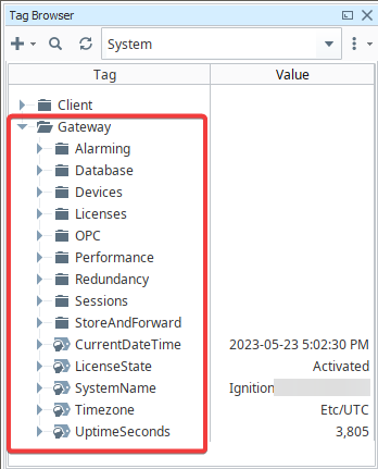

Gateway System Tagsβ
Gateway System Tags exist in the Gateway scope. There are several folders within the Gateway Tags folder which report metrics on various Gateway level systems.
The following Gateway-scoped System Tags are available.
Root System Tagsβ
Name | Description | Data Type |
CurrentDateTime | Current system date and time. Format is yyyy-mm-dd hh:mm:ss a. | DateTime |
LicenseState | New in 8.1.15 Returns the license state of the Gateway. If a valid license is applied, the tag will return "Activated". This includes Emergency Activation mode and Maker licensing. For any other license state, the tag will return "Trial". | String |
SystemName | Returns the name of the system where the Ignition Gateway is installed. | String |
Timezone | Timezone on the Gateway computer. For example, America/Los Angeles. | String |
UptimeSeconds | Number of seconds since Ignition was started. | Long |
