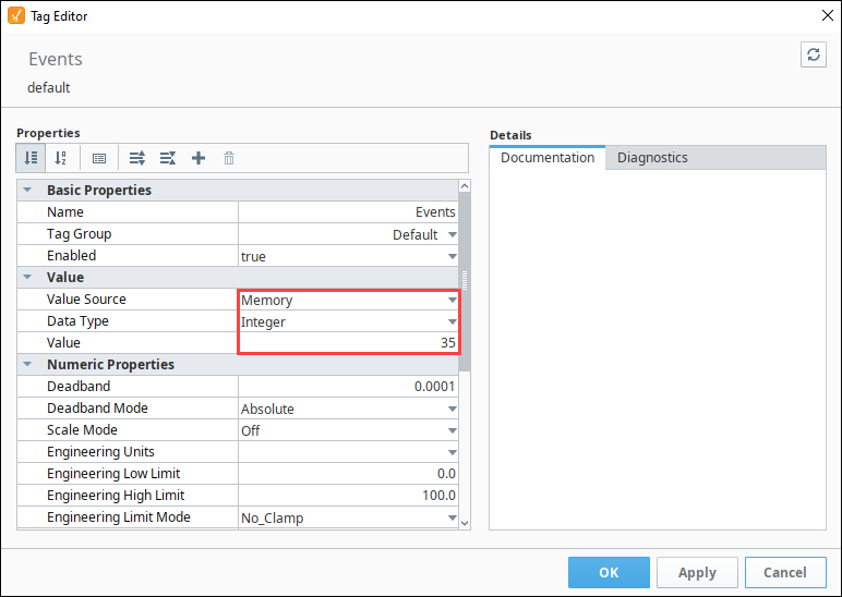

Memory tags are simple tags, that do not automatically poll or update their value. They hold the same value until some other user-created mechanism (most likely a script or binding) changes their value. They're useful in situations where a value must be stored outside of a PLC or database.
The state of Memory tags are stored inside the gateway's internal database. This allows the tag and its value to be retained across Gateway restarts.

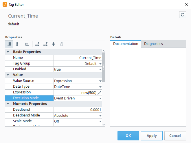

Expression tags are driven by an expression, allowing their values to be determined from a calculation.
The Expression property on Expression tags determines their value. The expression can reference values and properties on other Gateway-scoped tag values. However, due to scoping, they can not reference property values on Vision Client and Perspective Session components.
The expression on an Expression tag executes based off of the Execution Mode. More information on Execution Mode can be found on the Tag Properties page.

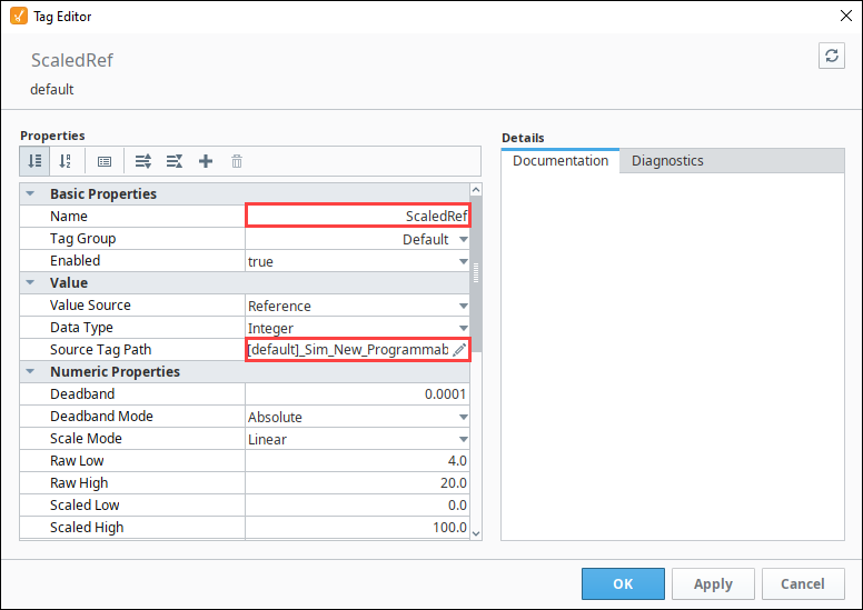

Reference Tags​
A Reference tag simply refers to an existing tag, using the Source Tag Path property to determine which other Tag to reference. Writes targeting the Reference tag will send a write request to the source tag.

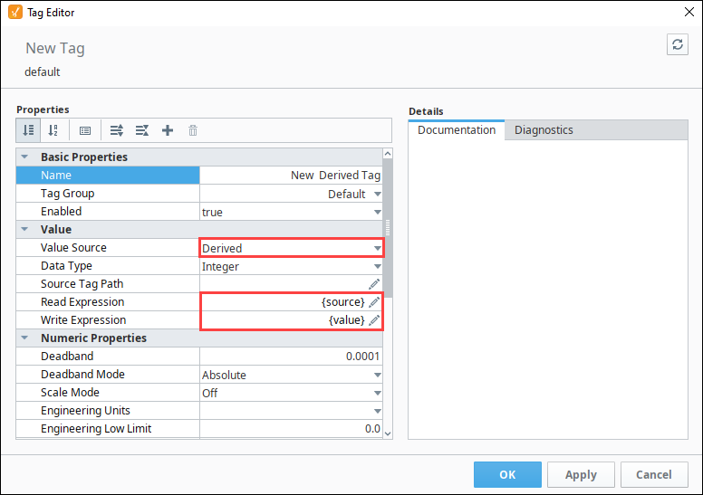

Derived Tags​
A Derived tag is an abstracted tag that refers to another tag. They are similar conceptually to Reference tags in that that value is dependent on the Source Tag Path property, but Derived tags have some additional functionality. Namely, they can apply expressions to the referenced value with the Read Expression property, allowing the value on the Derived tag to differ from the source tag.
In addition, The Write Expression property will apply an expression to the value of any write requests targeting the Derived tag, allowing the expression to modify the value of the incoming write before it's applied back to the source tag.
PropertyDescription
Read ExpressionDetermines what value should appear on the Derived tag. The current value of the source tag may be referenced with the {source} reference.
Write ExpressionWhen writing to the Derived tag, this expression determines what value should be written to the source tag. The current value of the source tag may be referenced with the {source} reference. The raw value passed to the Derived tag may be referenced with the {value} reference.
This interface provides an opportunity to scale the written and read value. For example, if the source tag was in Fahrenheit, and the Derived tag should be Celsius, we could use the following expressions:
//Read Expression
({source}-32)*(5/9)
//Write Expression
{value}*(9/5) + 32

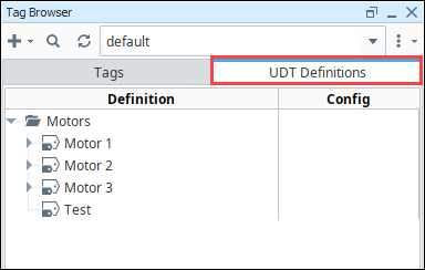

User Defined Types (UDTs)​
UDTs are created out of standard tag types, but they offer a variety of additional features. You can think of them as a way to create "data templates", where a particular structure of tags is defined, and can then be created as if it were a single tag. This UDT example shows two Motor instances, the data type Motor, and all the Parameters and tags that make up the structure (i.e., Amps and HOA). For more information, see User Defined Types - UDTs.

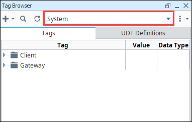

System Tags​
System Tags provide status about the Ignition system. They're generally cannot be modified, but provide use information about how the system is performing.
More information can be found on the System Tags page.
