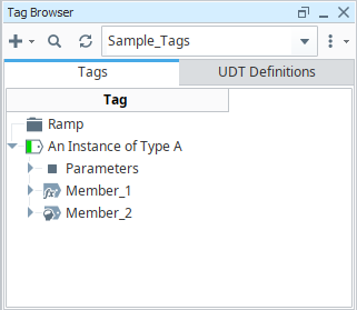

Instances are running copies of a Definition. All Instances have a "Parent Type", which is the definition that the Instance is inheriting from. The structure of an Instance is defined by its parent Definition, so you can not add new Members to an Instance. However, you can override the values on properties in any Member.
In the Tag Browser, UDT Instances can be found under the Tags tab, and are signified by either a plain white Tag icon, or a Tag icon with a vertical stripe. Furthermore, you can expand the UDT Instance and find the members (other Tags) in the UDT.

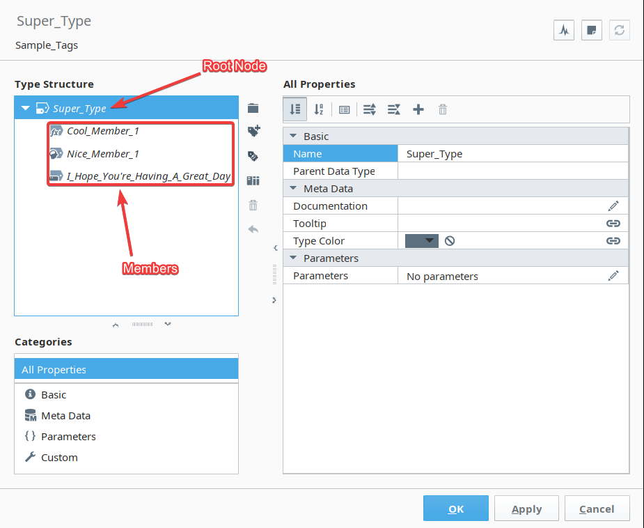

Root Node
The top level item in a UDT.
Members
Members are the Tags inside of a data type or instance. Members are always under a Root Node. Members can be standard Tag types or an instance of another UDT.

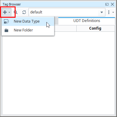

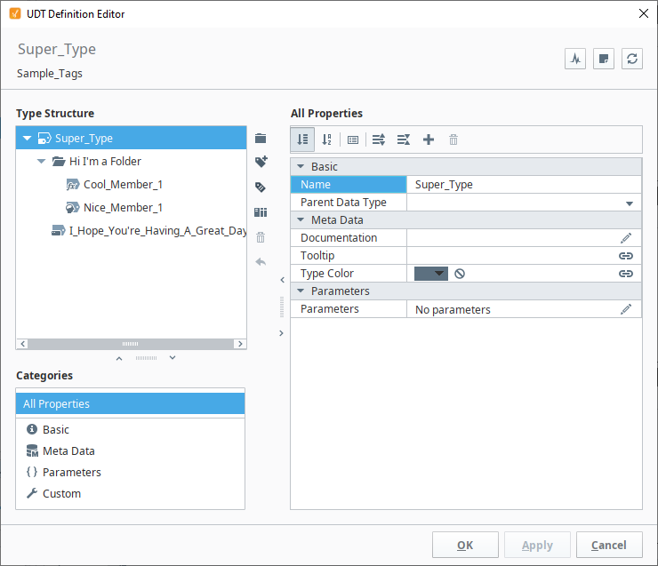

  1. To create a UDT Definition, first switch click on the UDT Definitions tab in the Tag Browser. This is the only section where you can make UDT Definitions.
  2. Next click the Add icon, and select New Data Type from the dropdown.

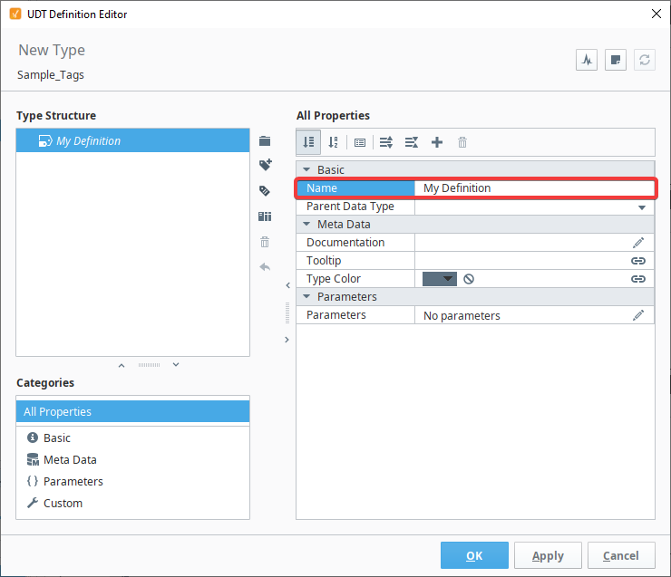

  3. The Tag Editor will open, allowing you to create a new UDT Definition. To start, enter a name into the Name property. (For this example we used "My Definition".) This name is how the UDT will be identified by the rest of the system.:
    note
    Names can be changed later, but doing so after you've already made instances will create what's called an "orphaned UDT instance:" an instance that is no longer associated with a definition. It's generally advised to avoid changing the name of a definition unless you're also willing to update any of the instances.

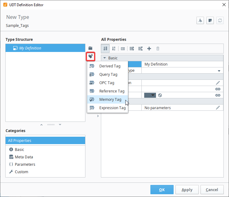

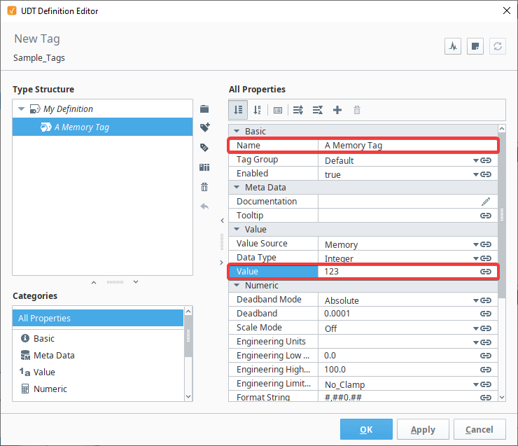

  4. We'll keep this demonstration simple, and only add two members. We'll create a Memory Tag and add a Tag from a connected device. Let's create the Memory Tag first. Click the New Tag icon, and select Memory Tag.
  5. The Tag Editor will now add a memory Tag to the Type Structure tree and select it, allowing the Properties table to show settings for the selected Tag.
  6. Change the Name to "A Memory Tag", and set a Value of 123.

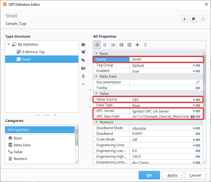

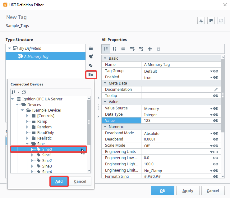

  7. Now, let's add a Tag from the OPC UA server. Click the Connected Devices icon, and a window will open showing you your Connected Devices. Expand Ignition OPC UA Server>Devices>Generic>Sine, and select Sine0. Click Add.
    New in 8.1.1
    As of 8.1.1, you can browse OPC devices from within the Tag Editor in order to add OPC nodes to UDT definitions.
    note
    When adding Tag(s) from a device, it requires that you have some connected devices such as the Ignition OPC UA Server as in this example.

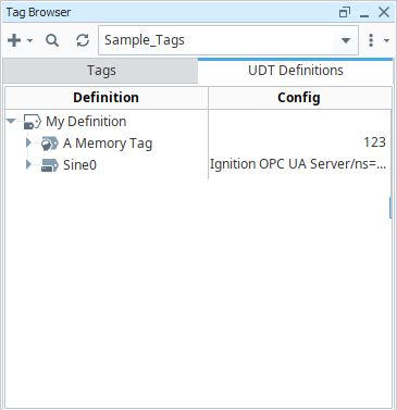

  8. You'll see that the Sine0 Tag was added to the Type Structure. Select the Sine0 Tag and you'll see all the property settings for that Tag.
  9. Click OK. This will close the Tag Editor, and apply your changes. The Tag Browser will now show your UDT Definition. You can expand the "My Definition" item to make the Memory and Sine0 Tags visible.

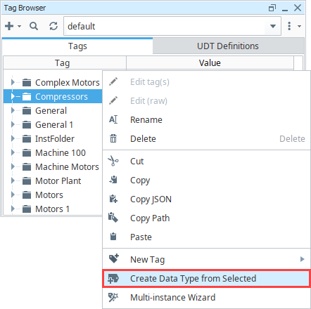

Creating a Data Type from Existing Tags​
New in 8.1.5
Version 8.1.5 added a feature that allowed data types to be created from existing tags.
To create a data type from existing Tags, simply select the Tags or folders you wish to include, right-click and select Create Data Type from Selected. The Tag Editor window is displayed with the selected tags pre-populated as members. From here you can modify the Tags, add parameters, and so on. The original Tags will not be affected.
tip
If you select a single folder as the root to create the type from, its sub-members will be added, and its name will be the basis for the type (that is, the folder itself won't be included in the structure).

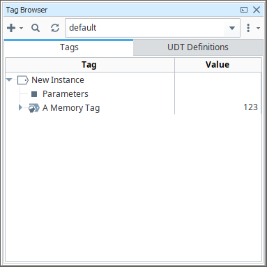

Creating an Instance​
Now that we have a UDT Definition, we can create a UDT Instance. You can use the Multi-Instance Wizard to make many instances quickly, but you can also create a single instance.

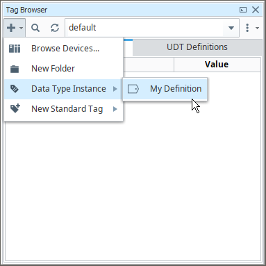

  1. In the Tag Browser, switch back to the Tags tab. This section of the Tag Browser is where you create UDT instances. Definitions can not be placed in this section.
  2. Click the Add icon and hover the mouse cursor over Data Type Instance. This will expand and show all of the UDT Definitions that exist within the active Tag Provider. Select the Definition we created in the previous example.

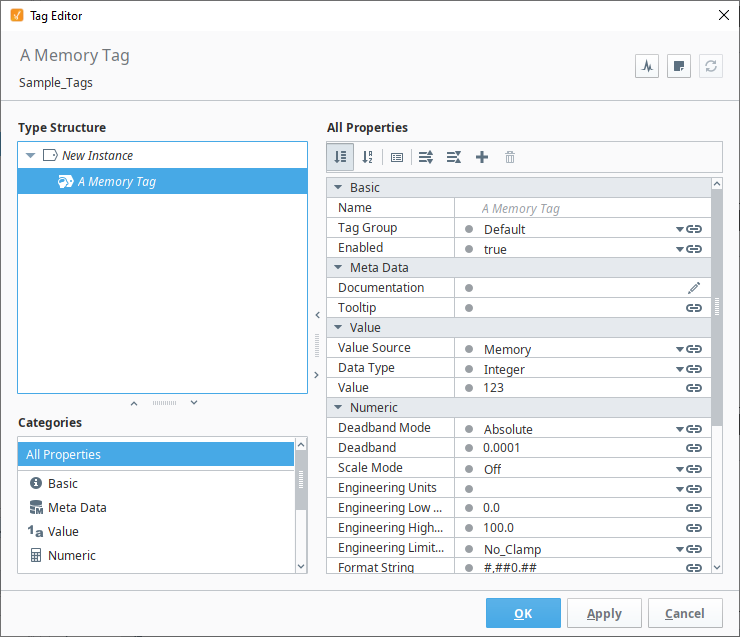

  3. Again, the Tag Editor will open. This time allowing you to edit an instance of the UDT. From here you can name the Instance. In this case we'll use the name "New Instance".
  4. If you select the member ("A Memory Tag"), you'll notice that many of the properties have a grey dot. This signifies that the properties are inheriting their values from the definition.
  5. We won't make any changes here. Just click OK, which closes the Tag Editor and creates a UDT instance.

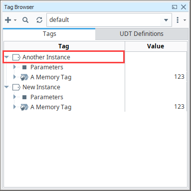

Override Instance Properties​
Instances inherit their structure and properties from the Definition, but property values can be overridden on an instance.
  1. Now that we have an instance, let's create another. You can use the same steps in the last example, or just copy and paste New Instance from the Tag Browser's right-click menu.
  2. Name the new instance "Another Instance".
  3. If you need to make changes to a UDT Instance, you can open the Tag Editor by double clicking on the Instance, or any of its members.

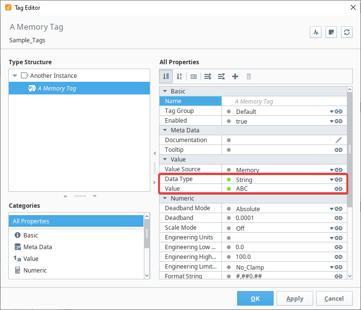

  4. With both instances expanded, we can see that aside from the names, they're identical. Let's change that. Double click on Another Instance or any of its members to open the Tag Editor.

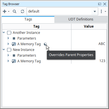

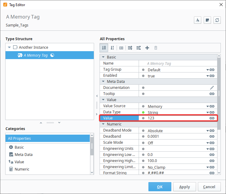

  5. With the Tag Editor open and focused on Another Instance, select the memory Tag. Change the Data Type to a String, and the Value to "ABC". You'll notice that as you make changes to the properties, the grey dots become green signifying that the property values now differs from the Definition. This concept is known as "Overriding" a UDT member property.
  6. Click OK to close the Tag Editor and apply your changes. You'll notice that the memory Tag in the instance we edited now has an attribute icon, signifying that one or more properties on the member are overridden.
  7. If you wish to remove the overrides, simply edit the Tag again, and click on the green dot. This will remove the override and cause the property to revert to the value on the Definition.

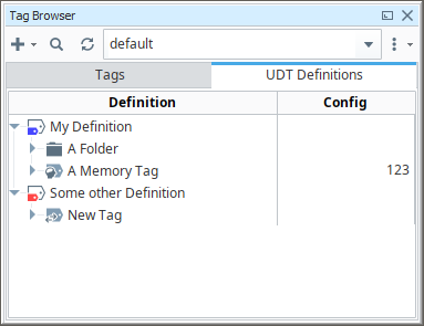

Make Changes to the Definition​
Now that we have some instances, we can make a modification to the Definition, which will propagate the change down to the Instances.

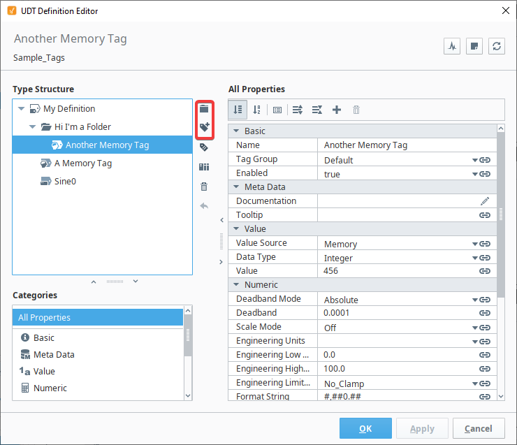

  1. Switch back to the UDT Definition tab in the Tag Browser.
  2. Edit the My Definition UDT.

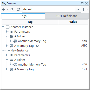

  3. Use the Add Folder and Add Standard Tag icons to add a new folder, and a member inside of that folder.
  4. Click OK to switch back to our instances,. You'll see they now both have new members.

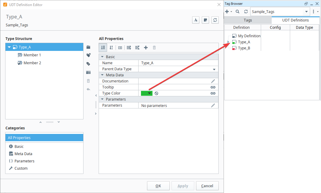

Type ColortypeColor
New in 8.1.0
A color that will be applied to the Definition and any Instances. This property is only cosmetic, but can be useful to have certain UDTs stand out from others in the Tag Browser.

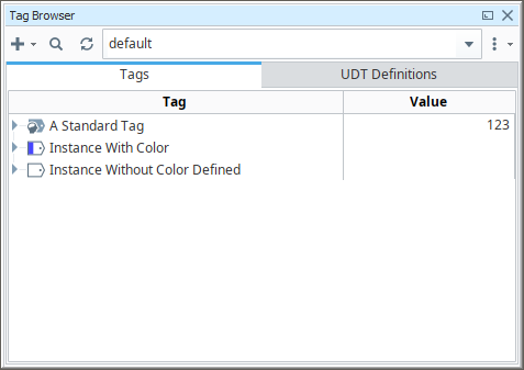

Assigning Colors to UDTs​
New in 8.1.0
UDTs can be color coded, which applies a color to the Root Node. This is purely a cosmetic change, but can be helpful in systems with a large number of instances, as the colors can make certain UDTs stand out from one another.
Color is applied to the Definition, via the Type Color property.
Any instances of that type will apply the color to the Root Node.
