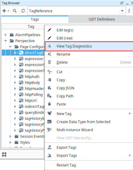

Accessing the Tag Diagnostics Window​
To access Tag Diagnostics for a specified tag, right-click on the tag in the Tag Browser and select View Tag Diagnostics. This will open the Tag Diagnostics window, which contains a Diagnostics, Active Subscriptions, and Reference Logs tabs.
Tag Diagnostic Values​

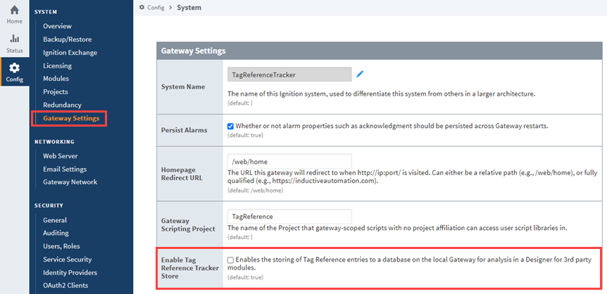

Enabling/Disabling the Tag Reference Store​
The Tag Reference Store is enabled by default on new installations and disabled by default on upgrades from Ignition versions 8.1.33 and earlier. There are two options to enable or disable the Tag Reference Store depending on the provider type.
  • For Realtime Tag Providers, standard and remote: Navigate to the Config > Tags > Realtime on the Gateway to access the Realtime Tag Providers page. Select edit for the provider you want to enable/disable and expand the Show advanced properties section. If the Enable Tag Reference Tracker Store property is checked, it is enabled.
  • For managed providers, like third party modules and the system provider: Navigate to the Config > System > Gateway Settings on the Gateway to access the System Settings page. If the Enable Tag Reference Tracker Store property is checked, it is enabled. Be prepared that this setting impacts all managed providers throughout the Gateway, so a large number of third party modules can result in large data collections.
note
Disabling the Tag Reference Tracker will not impact the Diagnostics or Active Subscriptions tabs, but the Reference Log will no longer track tag information.
