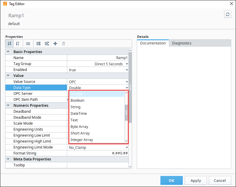

The data type of a tag is determined by the Data Type property, which is accessible from the Tag Editor. The tags system will attempt to coerce any raw incoming value (for example, from OPC or a SQL query) into the desired type.
The following table lists all the data types available for tags in Ignition.

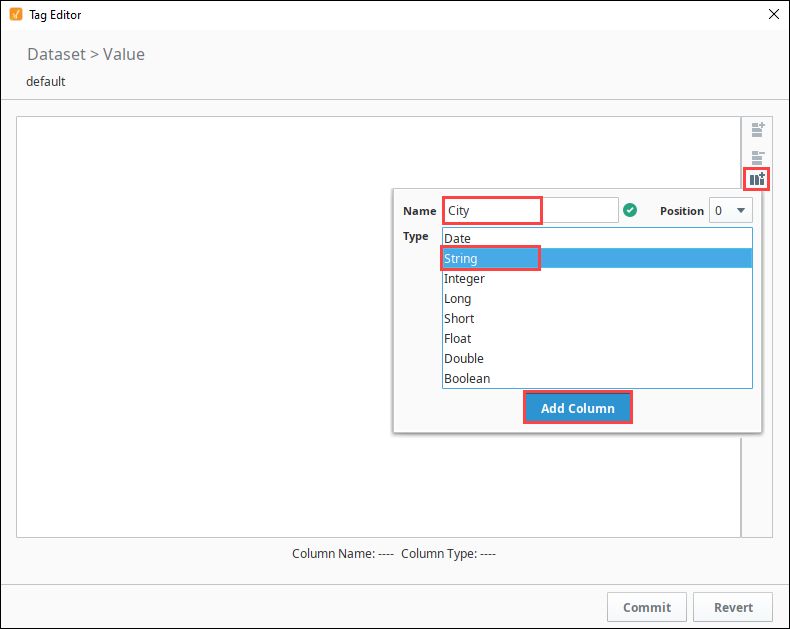

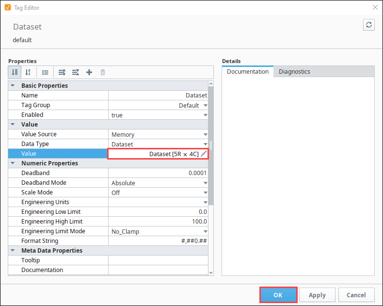

    1. Create a new Memory Tag. Name it Dataset, and change the data type to Dataset. The Dataset will be empty by default.
    2. Click the Edit icon next to Value. The Value screen is displayed. For this example, we created a simple dataset with four columns and five rows.
    3. Click the Add Column icon. Name the first column City and set type to be String.
    4. Click Add Column.

    7. Click the Commit button.
    8. Click OK to save the tag.

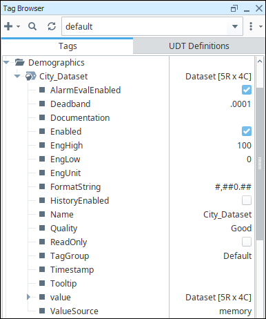

    The tag will now contain rows, columns, and values based on the configurations you made earlier in this example. Now you have a tag with a dataset value that can be bound to by components in Vision and Perspective.

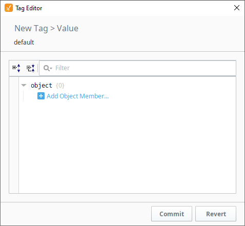

    Clicking the icon will transition the Tag Editor into a JSON Editor, allowing you to manually write JSON directly to the value.
    Click the + icon to add new members to the object. When finished, press Commit.
