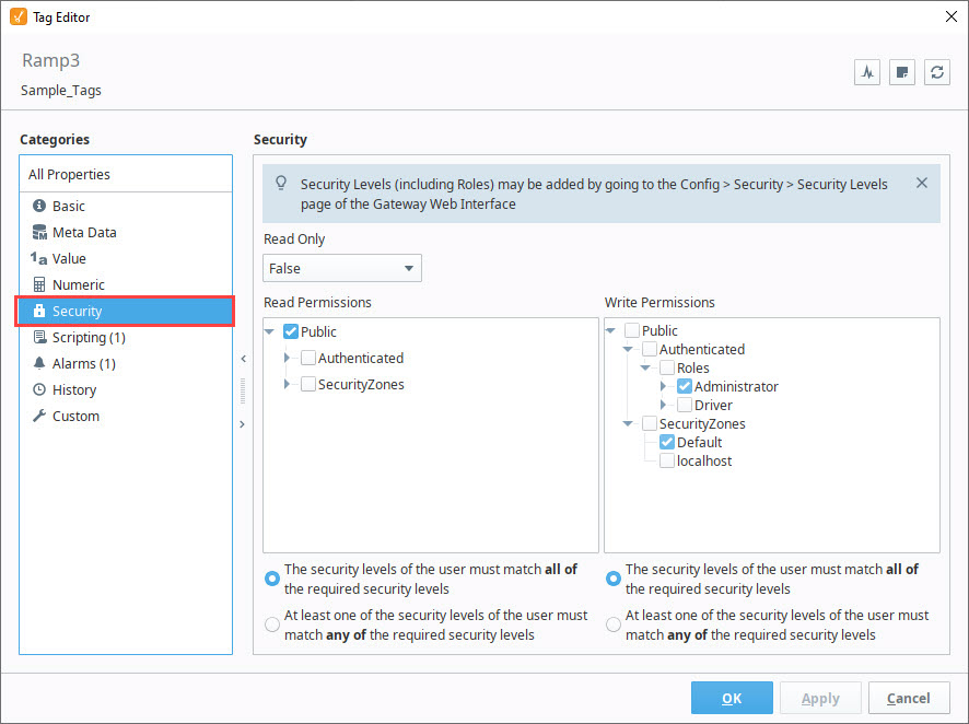

Instead of making a tag Read Only for all users, you can conditionally provide read and write access based on Security Levels. Doing so involves a adjusting the security settings on the tag in question. The checkbox tree you are presented with will show you all of the security levels configured in the Gateway Config > Security > Security Levels page.
Read Permissions​
Read permissions define the security levels required in order to read values from a Tag. By default, Tags have Read Permissions set to "Public". You can change the Read security using the Tag Browser in the Designer.
- In the Tag Browser, right-click on the Tag, and select the Edit icon.
- Select the Security section.
- On the screen, choose the security levels you want to have Read permissions for this Tag. In this example, only users with role of "Driver" will be able to see the Tag value.
- Click Commit to accept the settings.
- Click OK to save the changes to the Tag.

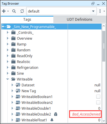

- If you are logged in as a user other than Driver, you will now see the "Bad_AccessDenied" in the Tag Browser instead of the Tag's value.

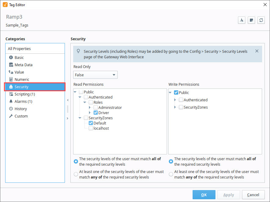

- On the screen, choose the security levels you want to have write permissions for this Tag. In this example, only users with role of Administrator will be able to write to the Tag value.
The deleted security level and all warning indications are removed when the deleted security level is unchecked and new settings are saved.
