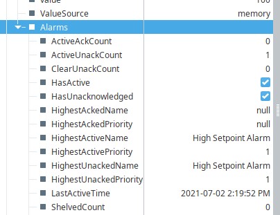

Runtime Alarm Metric Properties​
The Alarms property under a tag in the Tag Browser contains properties that report the current state of alarms on the tag.
| Property Name | Description |
| ActiveAckCount | The number of alarms on the tag that are both active and acknowledged. |
| ActiveUnackCount | The number of alarms on the tag that are both active and unacknowledged. |
| ClearUnackCount | The number of alarms on the tag that are both clear and unacknowledged. |
| HasActive | True, if the tag has at least one active alarm. False, if there are zero alarms. |
| HasUnacknowledged | True, if the tag has at least one unacknowledged alarm. False, if there are zero unacknowledged alarms. |
| HighestAckedName | The Name of the highest acknowledged alarm, ranked by Priority. |
| HighestAckedPriority | The highest Priority of all acknowledged alarms on the tag. |
| HighestActiveName | The Name of the highest active alarm, ranked by Priority. |
| HighestActivePriority | The highest Priority of all active alarms on the tag. |
| HighestUnackedName | The Name of the highest unacknowledged alarm, ranked by Priority. |
| HighestUnackedPriority | The highest Priority of all unacknowledged alarms on the tag. |
| LastActiveTime | A timestamp representing the last time an alarm went active on the tag. |
| ShelvedCount | The number of currently shelved alarms on the tag. |

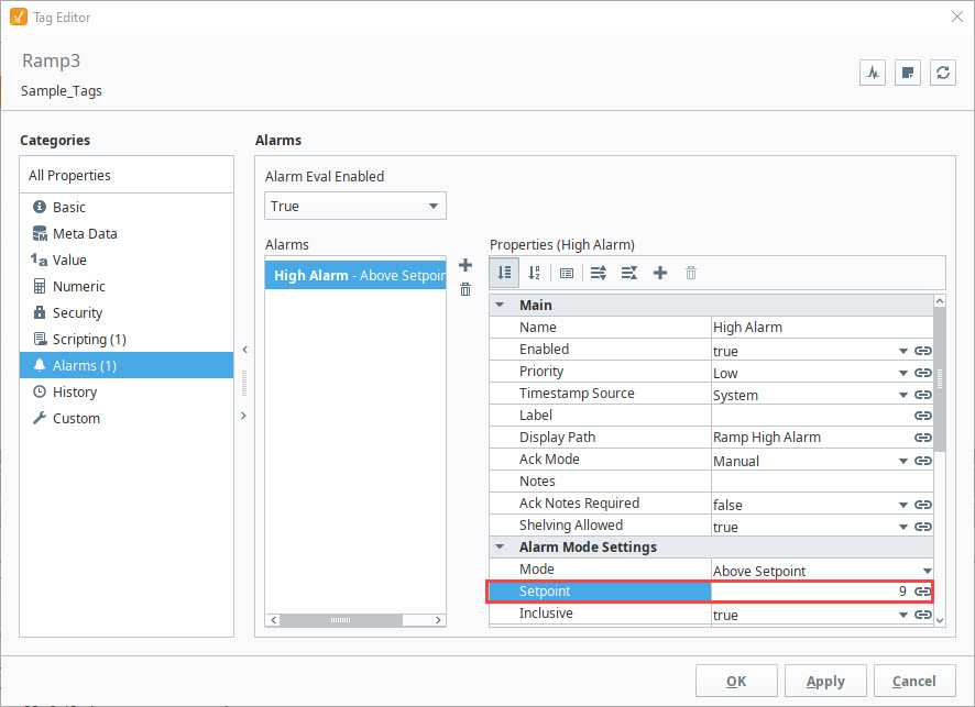

Binding​
Many alarm properties are bindable, which means they can be bound to other tags in the system, or expressions. For example, you might bind the enabled property to another tag which represents whether or not your process is running, thereby, disabling the alarm when production is stopped. Another example is you might bind the setpoint of an alarm to a tag that operators can manipulate, thereby, letting the setpoint be changed at runtime. For more information, see Configuring Alarms.
To bind an alarm property of a tag:
- Click on the binding

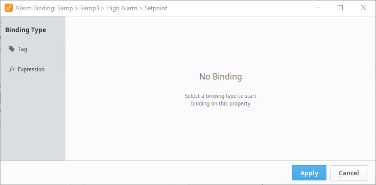

icon. An Alarm Binding popup window will appear.

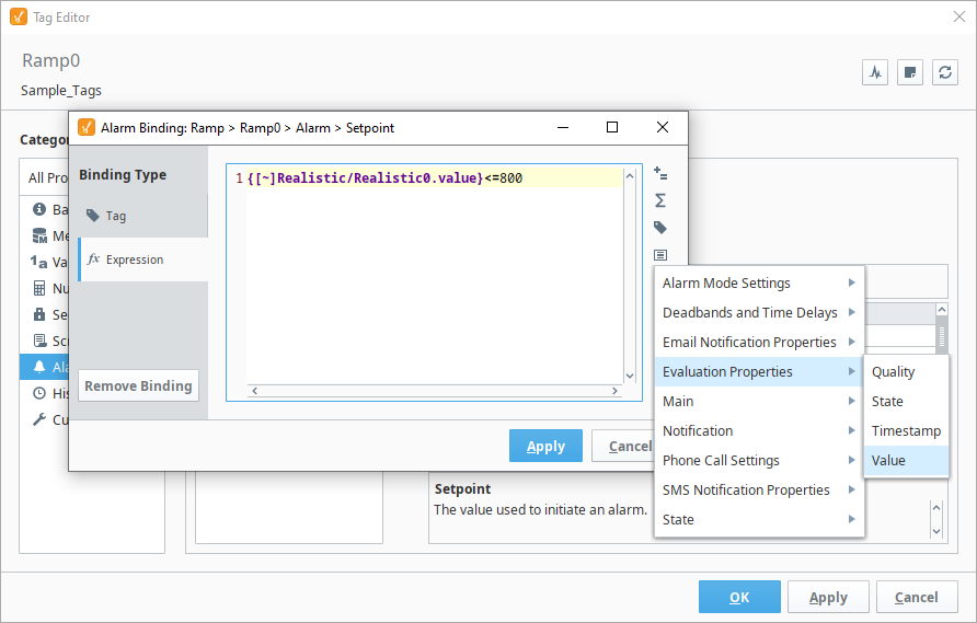

- From this window, you can select a Binding Type to configure a Tag or an Expression binding. For this example, let's select Expression. Binding to an Expression can reference many useful values such as the tag's value and other settings of the alarm.
- Now, enter your expression, using the Operators
, Functions
, Tags
, and Alarm Properties
selections as needed.
noteThe alarm properties that can be selected using the Alarm Properties
icon are the properties included in the Tag Editor > Alarms window or under the tag in the Tag Browser. See the Reference Table section and the Runtime Alarm Metric Properties section for descriptions of these properties. The State properties will only be available to view after alarming is enabled on the tag.
- When you configured the binding to your liking, click Apply.
