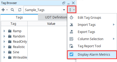

Runtime Alarm Metrics Properties​
The Alarm Metrics folder under a tag in the Tag Browser contains properties that report the current state of alarms on the tag. You are able to bind or subscribe to these alarm metrics, but direct reads are not supported to maintain efficiency and protect Gateway performance. However, creating a Reference tag for a specific alarm metric can then be used to read the value via scripting if necessary.
These properties include both standard alarm metric data, as well as total aggregated values. The aggregated alarm metric properties are aggregated by priority. Using these properties, you can list the specific aggregates, such as ActiveCountCritical in their own row, or use the wildcard notation to serve as the priority, such as ActiveCount(*).
The Tag Browser More icon includes an option to show/hide the Alarm Metrics. They are displayed by default, so the Display Alarm Metrics option will need to be unchecked if you don't want them to be visible.

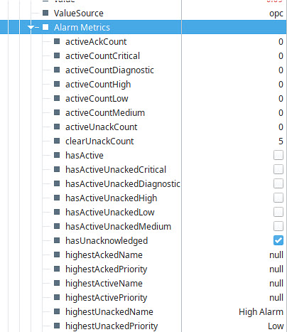

| Property Name | Description |
| ActiveAckCount | The number of alarms on the tag that are both active and acknowledged. |
| ActiveCount(Pri*) | The number of active alarms in each alarm priority. This aggregates all Active alarms, regardless of of Acked or Unacked. Includes the following count options:
| ActiveUnackCount | The number of alarms on the tag that are both active and unacknowledged. |
| ClearUnackCount | The number of alarms on the tag that are both clear and unacknowledged. |
| HasActive | True, if the tag has at least one active alarm. False, if there are zero alarms. |
| HasActiveUnacked(Pri*) | A boolean value to indicate that at least one alarm in a priority is in alarm, but not acknowledged. The value will be true when there are any Active or Unacked alarms and false when there are no Active and Unacked alarms. Includes the following count options:
| HasUnacknowledged | True, if the tag has at least one unacknowledged alarm. False, if there are zero unacknowledged alarms. |
| HighestAckedName | The Name of the highest acknowledged alarm, ranked by Priority. |
| HighestAckedPriority | The highest Priority of all acknowledged alarms on the tag. |
| HighestActiveName | The Name of the highest active alarm, ranked by Priority. |
| HighestActivePriority | The highest Priority of all active alarms on the tag. |
| HighestUnackedName | The Name of the highest unacknowledged alarm, ranked by Priority. |
| HighestUnackedPriority | The highest Priority of all unacknowledged alarms on the tag. |
| LastActiveTime | A timestamp representing the last time an alarm went active on the tag. |
| ShelvedCount | The number of currently shelved alarms on the tag. |
| UnackCount(Pri*) | The number of unacknowledged alarms in each priority. Includes the following count options:

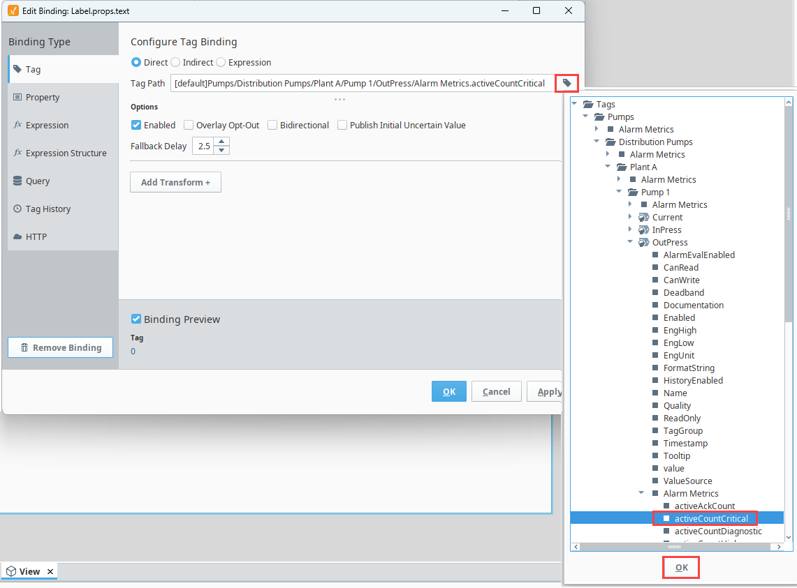

Syntax Examples​
The aggregated alarm properties can also be accessed using the dropdown in the Binding Editor for the Tag Path field, or entered directly using the syntax: <TagPath>/Alarm Metrics.<Alarm Metric property>.
For instance, if your Tag Browser has the tag and folder structure shown below, you can use the folder and tag data to collect alarm metrics anywhere from the Pumps level to the Outpress level. If looking for the Outpress level, the tag path would be your [Tag Provider] followed by Pumps/Distribution Pumps/Plant A/Pump 1/Outpress and Pumps/Distribution Pumps/Plant A/Pump 2/Outpress for Pump 1 and Pump 2.
Pumps
Distribution Pumps
Plant A
Pump 1
Current
InPress
OutPress
RPM
Temperature
Vibration
Pump 2
Current
InPress
OutPress
RPM
Temperature
Vibration
The following examples list the tag paths to use in the Binding Editor to get the count of all active critical alarms at each level.
## Pump 1 Outlet Press
Pumps/Distribution Pumps/Plant A/Pump 1/Outpress/Alarm Metrics.activeCountCritical
## Pump 1 All Alarms
Pumps/Distribution Pumps/Plant A/Pump 1/Alarm Metrics.activeCountCritical
## Plant A, All Pump Alarms
Pumps/Distribution Pumps/Plant A/Alarm Metrics.activeCountCritical
## All Distribution Pump Alarms
Pumps/Distribution Pumps/Alarm Metrics.activeCountCritical
## All Pump Alarms Tag Path
To use the Binding Editor to populate these paths instead, simply select the Browse Tags icon and navigate to the folder, UDT, or tag you want to select the Alarm Metric for. Once you've made your selection, click OK and it will fill the Tag Path field.

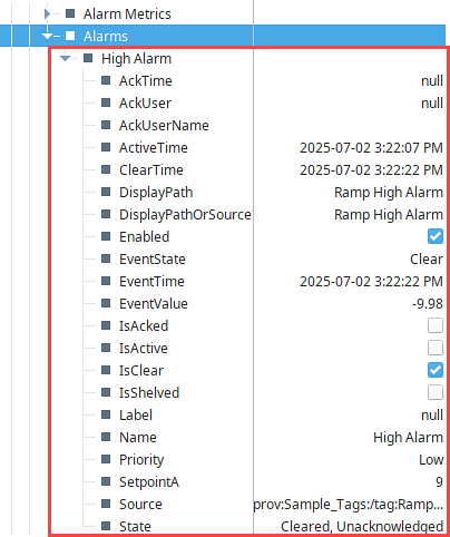

Runtime Alarm Metrics for Individual Alarms​
In addition to the metrics above, each alarm configured on a tag has further properties that are available. These properties are located in the Alarms folder. For each alarm on a tag, additional expandable items will be visible in the property editor. The name on these items will match the name of their associated alarm.
In the image below, the parent tag has one alarm configured, named High Alarm. When the Alarms folder is opened, the High Alarm folder can be expanded to show the individual alarm properties. If there are multiple alarms on a tag, the Alarms folder will show multiple folders, sorted by the name of each alarm.
The additional properties revealed are listed in the table below.
| AckTime | If the most recent alarm event for this alarm has been acknowledged, then this property will show a timestamp representing when acknowledgement occurred. If the most recent alarm event has not yet been acknowledged, the value of this property will be null. |
| AckUser | If the most recent alarm event for this alarm has been acknowledged, then this property will show the username that acknowledged the alarm event. Otherwise the value of this property we be null. If the alarm event was acknowledged by the system, such as when the Alarm Mode is set to Auto, then the property will show a null value. If the user that acknowledged the alarm event was authenticated via a User Source, then the value will follow the pattern below, where X is the name of the User Source, and Y is the name of the user. usr-prov:X:/usr:YIf the user that acknowledged the alarm event was authenticate via an Identity Provider, then the value will follow the pattern below, where Y is the name of the user. usr:Y |
| AckUserName | If the most recent alarm event for this alarm has been acknowledged, then this property will show the username that acknowledged the alarm event. Otherwise the value of this property we be an empty string.If the alarm event was acknowledged by the system, such as when the Alarm Mode is set to Auto, then the property will show an empty string. This property is effectively a simplified version of AckUser, containing only the username. |
| ActiveTime | Shows a timestamp representing when the most recent alarm event became active. |
| ClearTime | Shows a timestamp representing when the most recent alarm event transitioned from an active state to a clear state. |
| DisplayPath | Represents the value of the Display Path property on the alarm. |
| DisplayPathOrSource | Shows the display path if one has been configured. Otherwise shows the source path. |
| Enabled | Represent whether or not this alarm is enabled. |
| EventState | Represents the most recent state transition. A listing of states and their numerical values are listed below:
| EventTime | A timestamp representing when the event last changed state. |
| EventValue | Represents the last value that made the alarm event transition to either active or cleared. |
| IsAcked | A boolean representing whether or not the most recent alarm event has been acknowledged. |
| IsActive | A boolean representing whether or not the most recent alarm event is active. |
| IsClear | A boolean representing whether or not the most recent alarm event is cleared. |
| IsShelved | A boolean representing whether or not the alarm has been shelved. |
| Label | A string representing the Label property on the alarm. Shows a null value if a Label wasn't defined. |
| Name | The name of the alarm. |
| Priority | The priority of the alarm. A listing of priorities and numerical values are listed below:
| SetpointA | When the Mode property on the alarm has a single setpoint, this property shows the setpoint value. When the Mode property has multiple setpoints, this represents the Low Setpoint property. |
| SetpointB | When the Mode property on the alarm has a single setpoint, this property is hidden. When the Mode property has multiple setpoints, this represents the High Setpoint property. |
| Source | The source path of the alarm. |
| State | The state of the alarm. A listing of states and their numerical values are listed below:
