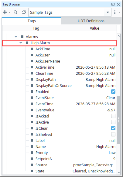

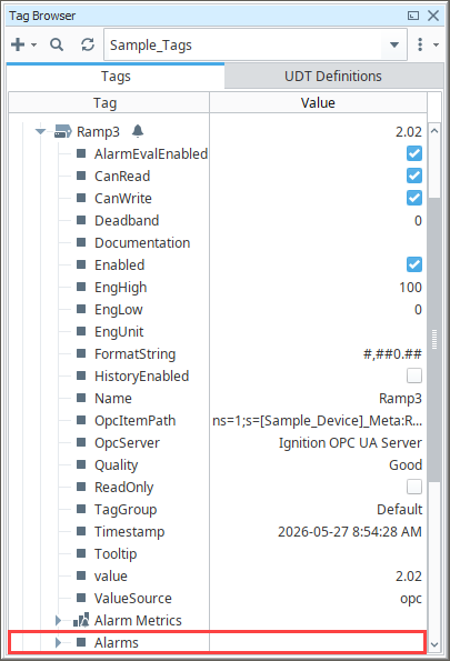

Aside from viewing alarm properties from the Tag Editor, you can also examine them from the Tag Browser. If you expand a tag that has an alarm on it, you'll find an Alarms item:

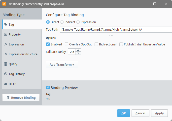

From here we can expand the Alarms item. We'll find several data points that represent the state of any alarms on the tag. In addition, can find runtime information for each alarm on the tag. In the image below, the tag has an alarm named "Ramp high". We can expand that tag to learn more about that alarm.
These sub properties are simply attributes on a tag, so Tag Bindings can be used to retrieve their realtime value. In the image below, we see a Perspective Tag Binding pointing to the State attribute of an alarm.
Alarm setpoint properties and the Enabled property can be modified directly from their attributes on the tag. This means component property bindings and scripts can change the setpoint or enabled state of an alarm during runtime.

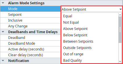

Alarm Modes and Setpoints​
There are many different conditions that can be set up on an alarm. Alarm Mode Settings is where you define the actual conditions when the alarm goes 'true.' Some of the various Alarm Modes are shown in the image below.
Each alarm is configured with one mode, and usually one or more Setpoints. Modes determine the method in which alarm activity is evaluated, while Setpoints are the thresholds or limits that determine when a tag is within the alarm state. Both properties work in together to determine when alarms become active, as well as when they are cleared.
For example, when Mode is set to "Above Setpoint", the Setpoint attribute is compared to the tag's value. When the tag value is above the the Setpoint value, the alarm becomes active. Once the value of the tag is less than the Setpoint value, the alarm will transition to a cleared state.
It may also be useful to set an alarm using the Bad Quality mode. If a tag goes into Bad Quality, alarms on the tag will not trigger since the tag value will never meet the trigger criteria. Setting an alarm on Bad Quality will help alert you if there is something wrong with the tag.
For a complete list of Alarm Modes and their descriptions, refer to the Reference Table on the Tag Alarm Properties page.

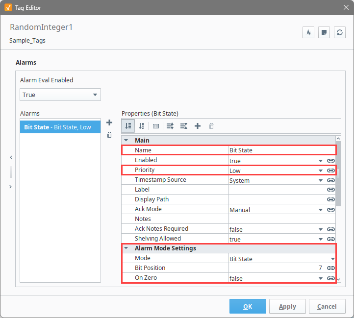

Alarming on Individual Bits​
Additionally, alarms can become active by bit state. A common practice for PLC programming is to store alarm conditions as series of bits inside the PLC and expose them to the world as an integer value. Each bit is essentially a binary value. A series of 8 bits, for example, could be represented as an 8-bit integer. This integer value can be monitored by Ignition's OPC-UA server as an integer value as a tag. This tag can then have as many alarms as the integer has bits by monitoring the integer's bit state. Using the Bit Position Mode, multiple alarms in Ignition can be configured to monitor the state of each bit.
The following table shows binary and decimal equivalents:
| Binary | Decimal |
| 10001110 | 142 |
In this case, the tag would be an integer with a value of 142. This tag would have eight alarms. Each one of these alarms become active in accordance with its Boolean value.

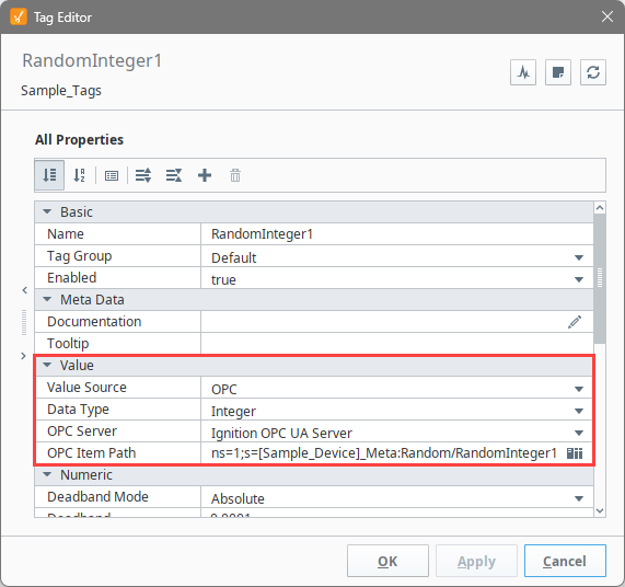

Create Alarms on an Integer Tag Value​
- Edit a tag that has an integer value.
- Scroll down to Alarms, and next to 'No alarms,' click on the Edit
icon to create an alarm.
- Click the Add
icon to add a new alarm to the tag.
- Fill in the appropriate properties, for example, enter the Name, Priority, and other properties as appropriate.
- From the Mode section dropdown, select Bit State and enter a value for the Bit Position.
- Click Commit to save the alarm. Repeat the same process for the remainder of the bits.

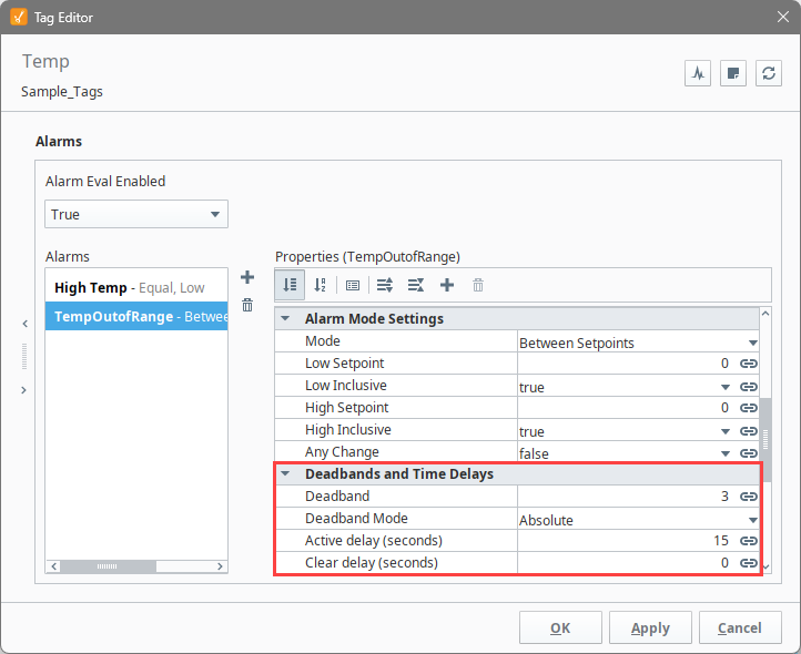

Deadband and Time Delays​
The value for the deadband is interpreted by the Deadband Mode. All alarms are only evaluated after the Tag's value changes, which means that the Tag's own deadband will be considered first. When the deadband is positive, an active alarm condition needs to clear its setpoint(s) by the amount of the deadband for the alarm to clear.
For example, suppose we have a "Between Setpoints" alarm with a Low Setpoint of 45 and a High Setpoint of 65, and with a Deadband of 3. The alarm will go active if the value is between 45 and 65, but will only clear if the value falls below 42 or rises above 68.
In other situations, a tag may frequently enter and leave an alarm state, but only for a brief moment. Normally an alarm would be generated each time the alarm condition was met, but the Active Delay attribute will prevent any alarms from being generated until the value on the tag has stayed in an alarm state for a set period of time.
To learn more about deadband and time delays, refer to the Reference Table on the Tag Alarm Properties page.

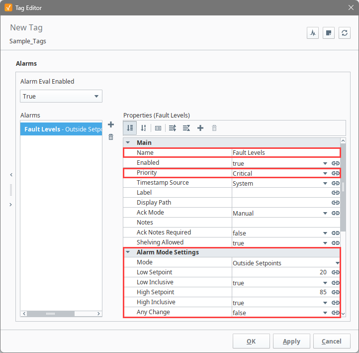

Configuring an Alarm on a Memory Tag​
Let's use a simple memory tag with an Integer data type and create an alarm.
- In the Tag Browser, double click a memory tag (i.e. Level) to open the Tag Editor.
icon to create an alarm, and the alarm UI will slide in from the right.
- Click the Add
icon in the bottom left corner of the window, or double click New Alarm item to add a new alarm to the Tag.
- Configure the following alarm settings:
- Name: Fault Levels
- Priority: Critical
- Alarm Mode: Outside Setpoints
- Low Setpoint: 20 (when the Low Setpoint is below 20, an alarm is triggered)
- Low Inclusive: true (alarm is triggered when the low setpoint is equal to 20 or below)
- High Setpoint: 85 (when the High Setpoint is above 85, an alarm is triggered)
- High Inclusive: true (when the High Setpoint is equal to or above 85, an alarm is triggered)
- Click Commit to save your alarm, or Revert to cancel.
- Click OK to save your tag edits.
- Ignition will start monitoring the alarm immediately. Notice that the Alarm

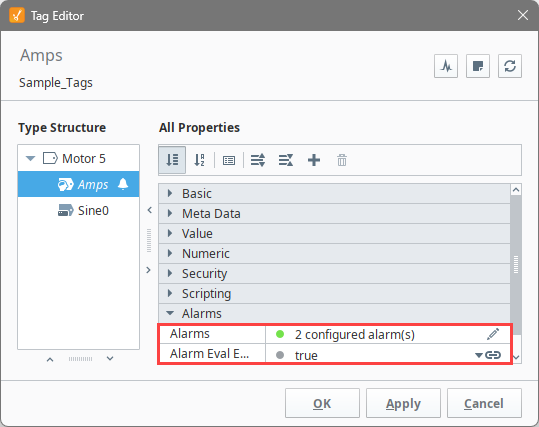

Configuring Alarms on Tags in a UDT​
Alarms can be configured on tags inside a UDT so when you create instances of that UDT, the alarms will automatically be configured.

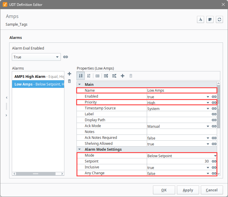

In this example, we have a Motor UDT that contains two tags: Amps and HOA. Let's configure an alarm on the Amps Tag.
- In the Tag Browser, double click on a UDT (i.e., Motor) to open the Tag Editor.
- In the Type Structure area, click on a tag (i.e., Amps).
- Scroll down to Alarms, and next to No alarms, click on the Edit
- Click the Add
icon.
- For this example, we entered the following:
- Name: Low Amps
- Priority: High
- Alarm Mode: Below Setpoint
- Setpoint: 30
- Inclusive: true (an alarm is triggered when the low setpoint is equal to 30 or below)
- Click Commit to save your alarm.
- Click OK to save the UDT. Now you're ready to create instances of the UDT. Once you create your UDT instances, Ignition will start monitoring the alarm immediately.

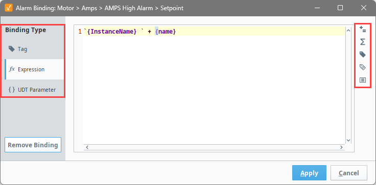

Alarm Property Bindings​
Many alarm properties are bindable, which means they can be bound to other tags in the system, expressions and even a UDT parameter. For example, you might bind the Enabled property to another tag which represents whether or not your process is running, thereby disabling the alarm when production is stopped. Or, you might bind the setpoint of an alarm to a tag that operators can manipulate, thereby letting the setpoint be changed at runtime.
This example shows how to bind an alarm property from the Tag Browser in Perspective.
- Double click on your tag to open the Tag Editor.
- Click on the Edit
icon next to Configured Alarms to see your configured alarms. (If you don't have any alarms, create an alarm using the steps in the Configuring an Alarm on a Tag.)
- Select the alarm and the screen will refresh with all the alarm properties.
- From here, find the alarm property you want to add a binding to and click on the binding icon. The binding UI will slide in from the right.
- Select the binding type (No Binding, Tag, Expression, or UDT Parameter, if applicable). The image below shows an example of an Expression binding. Notice that the expression can reference many useful values such as the tag's value and other settings of the alarm. Enter your expression.
- Once you configured the binding to your liking, click Commit, or Revert if you decide to cancel.
- Click OK to save the changes to the tag.
