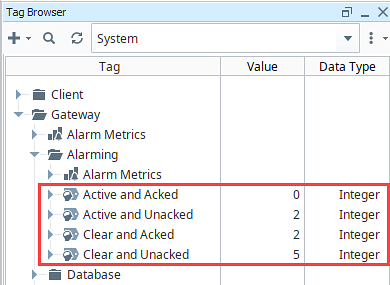

Alarm Count Tags​
Ignition provides a set of System Tags to view information about the Ignition server which includes four tags that count the number of alarms in each state. A quick way to see if any alarms are currently active and get an alarm count is to add Label components bound to these tags.
To view these tags, open the System Tag Provider in the Tag Browser of the Designer, and navigate to the Gateway > Alarming folder. These System Tags can easily be used to visualize all alarms in the system.
