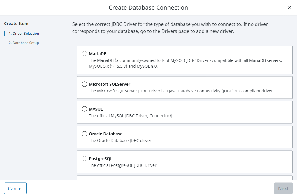

The first step in using a database with Ignition is to identify a database server. Many companies already have database servers maintained by their IT departments. If you do not, or wish to set up your own database server for Ignition, the Supported Databases section below offers some advice on choosing a database vendor.
Once you've identified a server, all you need to do is create a connection to that server to get up and running.

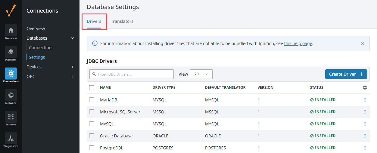

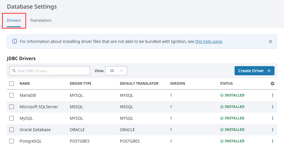

Supported Databases in Ignition​
Ignition has been tested with the following databases, and can connect to them directly after installation. You can connect to other databases by installing additional JDBC drivers (the Java database connection specification), which are often provided by database vendors.

Connections to other databases are possible as long as the JDBC drivers unique to the desired databases are installed. Due to variances in databases, some features may not work fully. However, careful use of the database translator can allow for full functionality.
Installing and Connecting to a Database​
Once you've identified a server, all you need to do is create a connection to that server to get up and running. See the Installing Databases and Connecting to Databases sections for details about how to install and connect to different databases through Ignition.
If we don't already have a connector for your database type, you can simply add it in yourself.
Database Drivers and Translators​
What Is JDBC?​
JDBC stands for the Java DataBase Connectivity API. It is a standardized way for Java-based applications to interact with a wide range of databases and data sources. A JDBC Driver enables Ignition to connect to, and use data from, a particular database system.
JDBC in Ignition​
Ignition, being a Java-based application, leverages JDBC in order to connect to a variety of data sources. This enables Ignition to offer a standardized set of functionality on a wide range of different systems and databases. This includes not only commonly-used databases such as MySQL, Microsoft SQL Server, and Oracle, but additionally other lesser-known systems as well, provided the manufacturer offers a JDBC driver for the system.

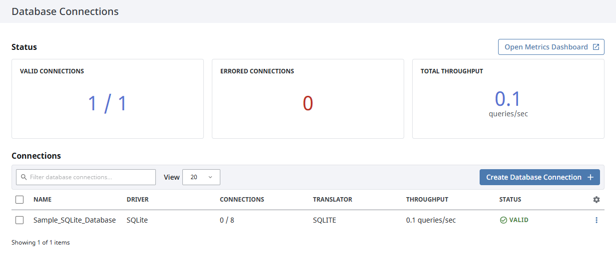

Monitoring Connection Status​
Monitor the state of your database connections from the Status section at the top of the page. The status panels show the current valid and errored connections, along with the throughput statistics for active connections. The Connections section directly below the status panels displays more details for each individual connection.
When a connection is not available, it is re-tested every 10 seconds, and the status is updated.
| Attributes | Description |
| Valid Connections | Number of valid connections. |
| Errored Connections | Number of errored connections. |
| Total Throughput | Number of queries and their statuses. |
| Name | Name of the query. |
| Driver | Name of the driver. |
| Connections | Number of database connections out of configured databases. |
| Translator | Name of the database translator. |
| Throughput | Number of queries running per second. |
| Status | Current status of the database connection. |

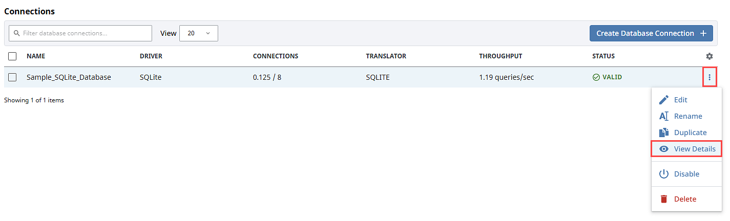

Database Connection Details​
Expanding the three dots menu and selecting View Details to the right of a connection will open a Connection Details panel. From here, you can see any active queries, long running queries, the number of queries a second that are running, as well as any log activity.
