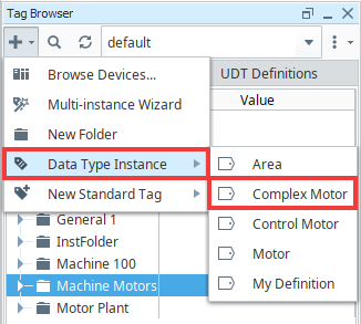

Creating the Data Type Instance​
Now that our Complex Motor UDT is set up, let's create a data type instance of the Complex Motor.
  1. Click on the Tag tab, and from the context menu, select the Data Type Instance > Complex Motor.
    Creating the Data Type Instance Step 1
  2. Enter the Name for the instance (i.e., Complex Motor 100). Click the Edit icon next to the Parameters property and enter the parameter value of '2' for MotorNumber and SensorNumber.
  3. Click OK to create the instance. Now, you'll be able to see all the values for Complex Motor 100 including the Temp Tag that was added.
