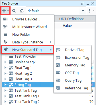

Tag Configuration in the Designer​
Tags are managed in the Tag Editor. To configure a tag, right-click on it and select Edit Tag. Or create a new tag by right-clicking on the Tags folder in the Tag Browser and use the New Tag option to select a new tag type.
Once the Tag Editor window is displayed you can set the properties for that tag. The Tag Editor window has the following sections depending on the type of tag you are creating:
  • Basic Properties
  • Value
  • Numeric Properties
  • Meta Data Properties
  • Security
  • Scripting
  • Alarms
  • History

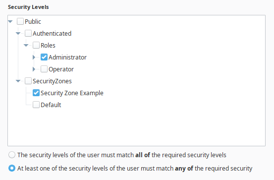

Security Data Properties​
PropertyJSON/Scripting NameDescriptionData TypeApplicable Tag Type
Read PermissionsreadPermissionsDefines the security levels required in order to read values from a tag. Roles under authenticated will show up based on property Security Levels being configured.
For more information, see Tag Security Properties.
See the Permission Values section for a description of possible values.
JSON ObjectOPC, Query, Expression, Derived, Reference, Memory

Permission Values​
ModeJSON/Scripting NameDescription
TypetypeRepresents the selected radio button on the security level UI, determining if all of the elements in the securityLevels array are required, or if any of the elements are allowed. Possible values are:
  • AnyOf
  • AllOf
In other words, a user logging in must satisfy either any of the selected criteria or all criteria selected.
Security LevelssecurityLevelsRepresents allowed security levels for this permission. Each level is represented as a JSON object, containing a "name" value that represents the name of a security level, and a "children" array which represents any levels under the current. The actual "selected" levels are any levels that have an empty "children" object. See the example below for more information.
JSON Example
The JSON in this example uses the configuration shown in the image below. Permission is granted if the security levels on the request are from either an "Administrator" user, or if the request originated from the "Zone A" Security Zone.
"readPermissions": {
"type": "AnyOf",
"securityLevels": [
"name": "Authenticated",
"children": [
"name": "Roles",
"children": [
"name": "Administrator",
"children": []
"name": "SecurityZones",
"children": [
"name": "Zone A",
"children": []
