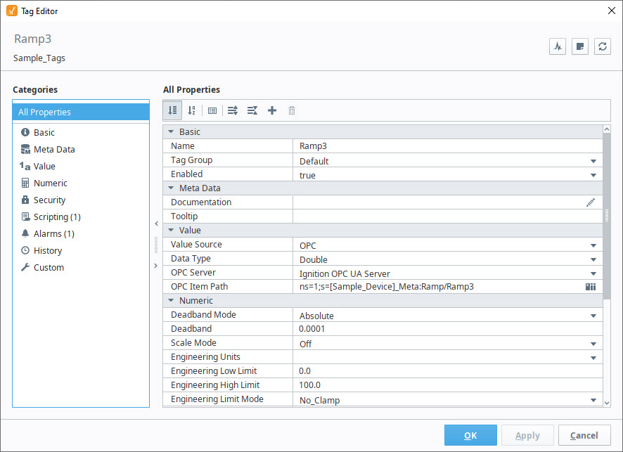

The Tag Editor is a robust interface that contains all the properties that can be configured for tags. In the Tag Editor, you set the tag's name, value, numeric and meta data properties, security, alarming, history, and more. For information an explanation on all possible tag configurations, see Tag Properties.
Diagnostics, Documentation, and Refresh icons are included on the upper right-hand side of the Tag Editor to access more tag information:
  • The Diagnostics icon opens the Tag Diagnostics window.
  • The Documentation icon displays a Documentation pane at the bottom of the Tag Editor.
  • The Refresh icon refreshes the editor with the current definition of the tag from the Gateway.
