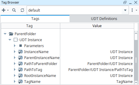

UDTs have a few parameters already defined to make things easier for you. They give you access to the name and various paths associated with a UDT member Tag. These parameters can be accessed from anywhere in a Tag that a normal parameter can be used. Each of these parameters uses that Tag it is in as a starting point for its path.
Parameter Name | Description |
{InstanceName} | The name of the UDT Instance that this Tag is inside. In cases where UDTs are nested, this parameter will return the name of the UDT the member belongs to. Thus referencing this parameter in a nested UDT will return the name of the nested UDT. |
{ParentInstanceName} | New in 8.1.13 The instance name of the parent UDT Instance. This is similar to InstanceName, except the name of parent UDT Instance will be returned when binding from UDT Instance parameters. |
{PathToParentFolder} | The full path to the folder that this Tag is in. |
{TagName} | The name of the Tag that is using this parameter. |
{PathToTag} | The full path to the Tag using this parameter. |
{RootInstanceName} | New in 8.1.13 Returns the top-most UDT Instance name. |

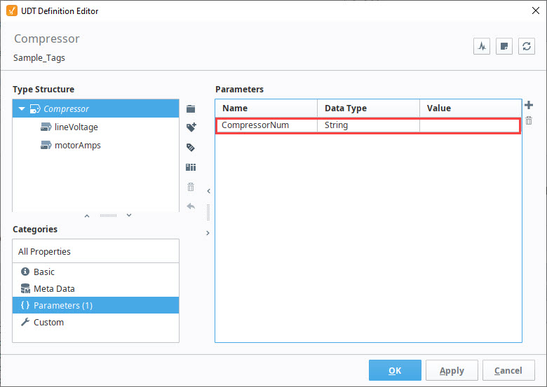

In this example, our plant has multiple compressors. We created a Compressor UDT, but we want each instance of the Compressor UDT to reference a different set of Tags. Our Compressor UDT has two OPC Tags: lineVoltage and motorAmps. These two Tags are pointing to a specific address in the PLC. In order to reference a different set of Tags for each instance, we need to add a parameter to our Compressor UDT that we called "CompressorNum."
- In the Tag Browser, we clicked on the UDT Definitions tab to find our Compressor UDT.
- Double click on the Compressor UDT to open it in the Tag Editor and click on the edit icon next to the Parameters property. The Parameters pane will open.
- Click the Add icon to create a parameter. Enter the parameter Name and Data Type of String.

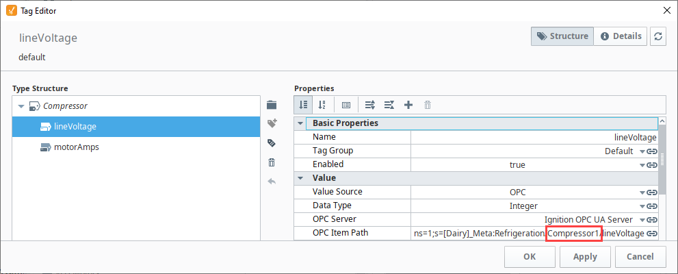

In the Tag Editor, replace the Compressor Number for each Tag with the new parameter CompressorNum. Select the lineVoltage Tag and click on the binding icon and click Edit.
This opens the OPC Item Path window for editing the lineVoltage Tag. Place your cursor at the end of 'Compressor1', delete the '1', and enter '{CompressorNum}'. Click Commit.
Changed in 8.1.17Starting in version 8.1.17, you may also edit tag paths inline in the Tag Editor rather than opening the OPC Item Path window. For this example, you would highlight '1' in the OPC Item Path and replace it with the new parameter, '{CompressorNum}'
Repeat Step 2 for the motorAmps Tag. .1 Both Tags will now show the CompressorNum parameter in the OPC Item Path.

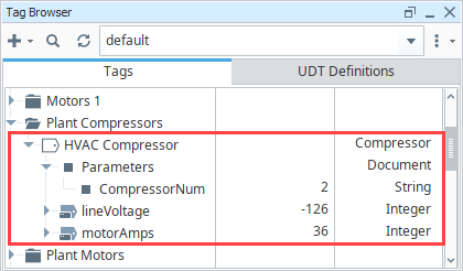

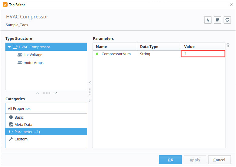

Now, let's create an instance of the Compressor UDT using the CompressorNum parameter under the Tags tab of the Tag Browser. To keep UDT instances organized, we created a Plant Compressors folder.
Right-click on the Plant Compressors folder and select New Tag > Data Type Instance > Compressor UDT.
Enter a Name for the Instance (i.e., HVAC Compressor), then click on the pencil icon next to the Parameters property and enter a value (i.e., 2). Click OK to save the HVAC Compressor instance.
Under the Tags tab, you'll see the HVAC Compressor was created showing the Parameter that was used and the values for the OPC Tags listed in the OPC Item Path.

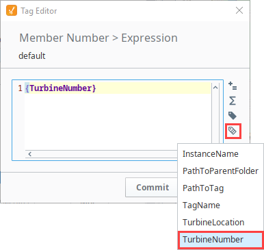

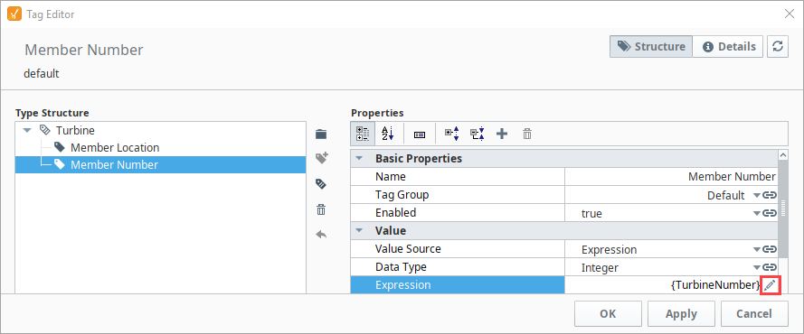

It is possible to use the value of data type parameters directly in expression bindings within a UDT. Parameter references can be quickly inserted into an expression.
While a UDT member is selected in the Tag Editor, you can edit bindable properties, such as the Expression on Expression Tags by clicking the Edit icon next to the property.
This opens the Expression window. Click on the UDT Parameters icon on the right of the expression area, select a parameter, then click Commit.

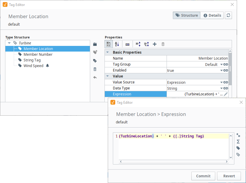

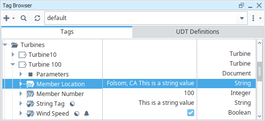

Because parameter and Tag references differ in syntax, some consideration must be made when attempting to use both in the same expression. Tag references must not be placed inside of quotes. After adding a string Tag to the Turbine UDT, a reference to the Tag can be added to Member Location's expression. Single quotes were added to create a space between the Member's Location and the string value.
Here's what it looks like in the Tag Browser.
