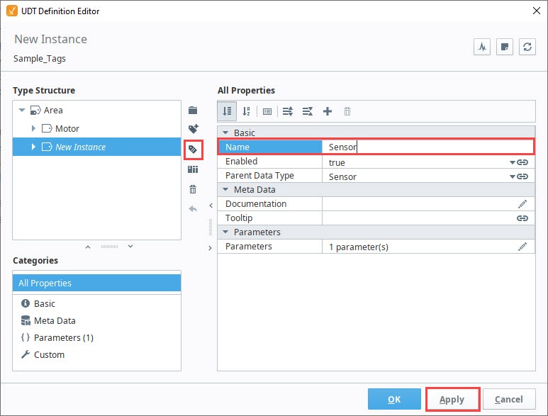

Motor. Click Apply. - Click on the New UDT Instance
icon, select New UDT Instance > Sensors/Sensor. Click OK.
- Rename the new instance
Sensor. Click Apply.

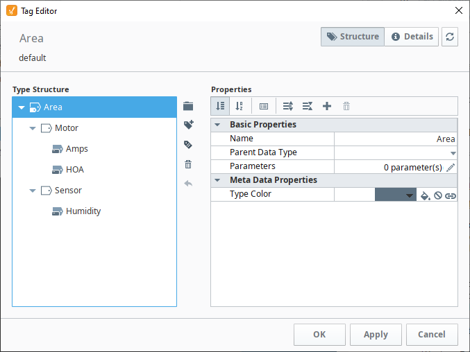

- With the Tag Editor still open, you'll notice that both the Motor and Sensor UDTs were added. For every UDT that you add inside another UDT, those UDT instances have parameters that need to be specified. In this example, the Motor UDT has the
MotorNumberparameter, and the Sensor UDT has theSensorNumberparameter. You must pass a value into the each of these UDTs (Motor and Sensor) from the parent UDT (Area). To view the parameters for each UDT instance, select each UDT instance (Motor and Sensor) and click the Editicon.

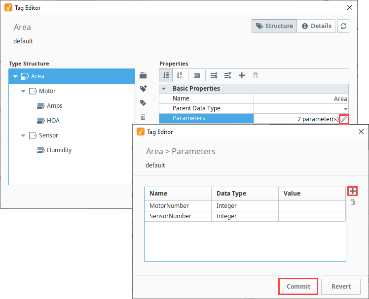

icon next to the Parameters property. The Parameters window will open.
- Click on the Add
icon to add the
MotorNumberandSensorNumberparameters, then click Commit.
