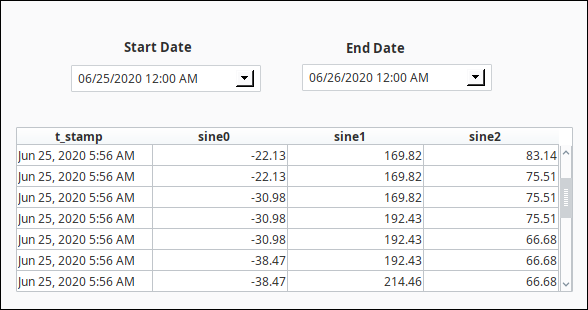

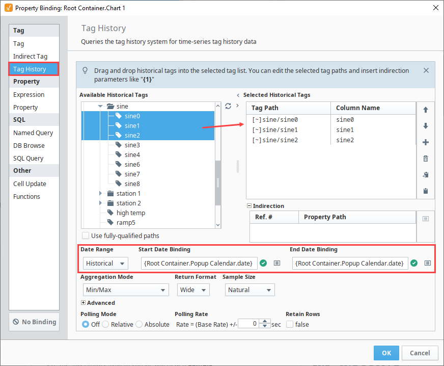

This example uses a Historical query and two Popup Calendars for the start and end dates. The history is presented in the Table below.
In the Designer, drag two Popup Calendar components and a Table component from the Component Palette into your workspace.
Select the Table and right click on the Binding icon for the Data property.
Drag a sine0, sine1, and sine2 under the Tag Path column under the Selected Historical Tags area.
Under Date Range, select Historical.
Under Start Date Binding, click on the Property icon and under one of the Popup Calenders, select Date.
Under the End Date Binding, click on the Property icon and under the second Popup Calender, select Date.
Click OK.
Now you can see the history of the three Sine tags along with a timestamp. You can scroll through the information in the table to see the history that was logged. To change the date range, click on dropdown buttons to bring up the popup calendars to change the date range. The tag history binding type allows you to bring back this history.

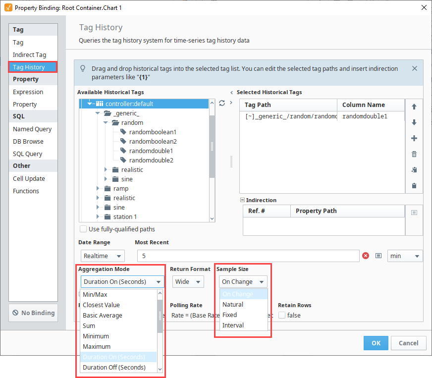

Sample Size and Aggregation Mode​
In places where the Tag History system can be queried, a Sample Size and Aggregation Mode can be selected that will determine how the results will be queried out and how the raw values will be aggregated.
Aggregation Mode​
The Aggregation Mode dictates what happens when multiple raw values are encountered for a given time slice. The number of values within a time slice is determined by the Sample Size properties. For more information on how time slices are populated, see the How the Tag Historian System Works page.

Sample Size​
The sample size determines how many data points will be returned from the query.
On Change​
An On Change query will return points as they were logged, and can be thought of as a "raw" query mode. This means that the results may not be evenly spaced. Also, it is important to note that every changed value will result in a row, and therefore if you are querying multiple tags and once, you may end up with more rows than you anticipated. For example, if Tag A and Tag B both change, you would end up with [[A0, B0],[A1, B0], [A1, B1]].
If you want to essentially retrieve raw values, while coalescing them down into fewer rows, try using the Interval sample mode, with an interval set to your largest acceptable time between rows, and select "prevent interpolation" from the advanced settings.
Natural​
A Natural query will look up the logging rate for the queried tags (when possible), and return results spaced apart at that rate. This means that the return size will vary with the date range.

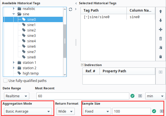

Fixed​
You can use the Sample Size and Aggregation Mode on the Tag History binding type to fix the number of records that are retrieved. The Fixed sample size will cause the binding to retrieve all records from the date range, and aggregate them evenly between a fixed number of points. This will ensure that the number of rows will remain the same without regard to the size of the dataset. In windows where users are able to select a large range of data, Fixed is recommended as it will prevent the property from loading an excessive number of records.
In cases where the number of points can not evenly represent the data from the date range, an extra point will be added, making the final size of the dataset the fixed value + 1.
Selecting the Min/Max aggregation mode returns two rows of data for every row requested. Each pair represents a minimum and a maximum result from the underlying data. Therefore, a table with a fixed length, would return double the requested amount with Min/Max aggregation mode selected. With Min/Max aggregation mode selected, and with a fixed row length of one, the data set returns the oldest tag value of the time range
The following image shows a Tag History Binding pulling data from the last one day. The Sample Size is configured to Fixed with a value of 100, and the Aggregation Mode is set to Basic Average. This means that the binding will query for data from the last one day, regardless of how many records there are, and create 100 time-slices that are evenly dispersed between the start and end periods of that range. Then, a basic average of the tag values are calculated for each time-slice. The resulting values are then returned to the property.
Note the Insert Property icon next to Sample Size. This allows a property binding to determine the number of data points, so you could change the size to increase or reduce the amount data points on the chart from the client.

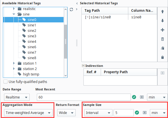

Interval​
Where as the Fixed sample size will calculate time slices based on the date range, the Interval sample size allows you to determine the size of the time slices. This sample size will divide the date range by the interval size to determine the size of each slice. Because of this, it is recommended to use an interval that is evenly divisible by the date range. However, in the event that the date range is dynamic or user driven, interpolation will handle any partially built slices. Even though the binding may attempt to evenly distribute the slices, there may be an extra row that represents the current values as they are building an interval.
The image below shows a Realtime range of 60 minutes. The Aggregation Mode is set to Time-weighted Average, and the Sample Size is set to Interval for 5 minutes. This means that the binding will query for data ranging from 60 minutes ago to now (or whenever the binding last executed, in the case that polling has been turned off). That 60 minute window will be divided as evenly as possible into 5 minute time-slices, so there should around 12 time-slices. Each time slice will aggregate its value based on the time-weighted average of all values within that slice.
The example uses a Realtime range, but a Historical range could easily be used instead.

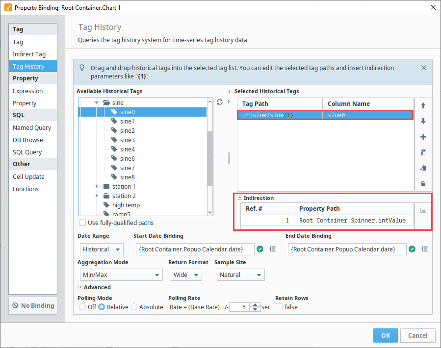

Indirect Tag History Binding​
The Tag History Binding can be made indirect by using Indirection parameters in the Tag Paths of the Selected Historical Tags. This works similarly to the Indirect Tag Binding, which uses Indirection References within the Tag Paths to substitute something into the path. Valid Indirection parameters consist of a reference number within curly braces. Simply type the Indirection parameters into a Tag path, selected by double-clicking. In this case, we will enter {1} as our Indirection parameter.
All valid parameters will appear in the Indirection table. For this example, the Tag Path points to the Spinner component for the indirection parameters.
