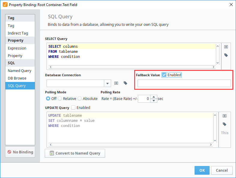

Scalar Query Fallback​
Inductive University
SQL Query Binding - Scalar Query and Fallback
Watch the video
If the property that is being bound is a scalar datatype (that is, not a Dataset), the value in the first column in the first row of the query results is used. If no rows were returned, the binding will cause an error unless the Use Fallback Value option is selected. The value entered in the fallback value text box will be used when the query returns no rows.
When binding a Dataset to a SQL Query, no fallback value is needed, because a Dataset will contain zero rows.
SQL Query Binding: Scalar Query Fallback
