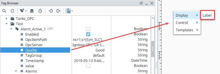

There are several ways to drag and drop Tags onto a component allowing you to create screens very quickly. You can quickly bind a Tag by dragging it from the Tag Browser into a component or into the component property.
Binding to a Component​
Ignition automatically creates the Tag bindings to several of the component properties when you choose to bind a Tag to a component by dragging and dropping. This is true for both creating a component by dragging and dropping a Tag onto empty space on a window at the same time Ignition prompts you for what type of component you want to create, and by dragging and dropping a Tag directly onto a component that already exists on a window. In both cases, Ignition automatically creates the Tag bindings on the component.

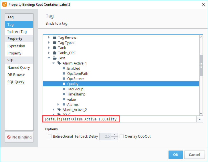

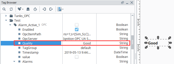

Aside from binding a property to a Tag's value, you can also bind to properties on a Tag, such as Tooltip, Quality, or AlarmActiveAckCount. This is useful when you don't need the value of the Tag, but rather the state, or some other configuration on the Tag. Here we see a boolean Memory Tag. It has a property indicating the Tag's quality. We can easily display that quality property on a component.
The simplest approach involves a Tag Binding. This can be achieved by dragging-and-dropping the Tag Property onto a Window, component, or component property. For example, you can drag a Tag's Quality property to a Label component.
This is similar to creating a standard Tag Binding, except we're using a property on the Tag instead of the Tag's value. The resulting Tag Binding would be:
[default]Test/Alarm_Active_1.Quality
Note that the proerty name has been appended to the path.
The Label component now displays the current value of Good for the Tag's Quality property.
