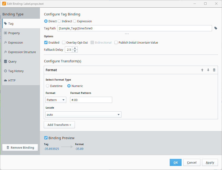

Numeric Pattern​
In the image below, an expression on a Tag binding is retrieving the value from a tag. As shown in the preview, the value on the tag shows -35.893925.
The Format Transform is taking that tag value, then applying a numeric pattern of #.00, which denotes that two digits must always be shown after the decimal point. As a result, the preview shows a Format value of -35.89, since any digits beyond the first two decimal places are ignored by the transform.
