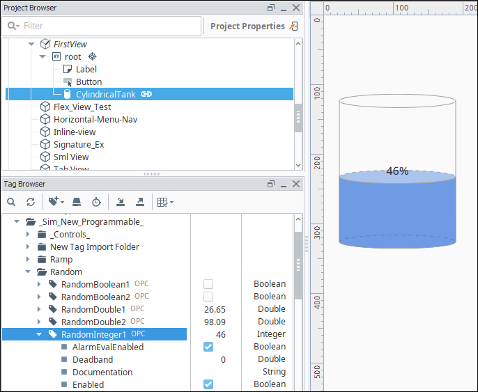

Ignition automatically creates the Tag Bindings to several of the component properties when you choose to bind a tag to a component by dragging and dropping. This is true for both creating a component by dragging and dropping a tag onto empty space in a container, and by dragging and dropping a dropping a tag directly onto a component property.
You can drag a tag onto a container. Perspective will give you an option for the kind of component you'd like to use to represent the Tag. Configuration options for tag drop are set in the Project properties. For more information, see Tag dropConfig. In this example we drag the tag for a tank onto a view and choose the Cylindrical Tank option.
A Cylindrical Tank component is placed on the view. Notice that the value for the component and the value for the tag match. The component's displayed value will update as the tag updates.
