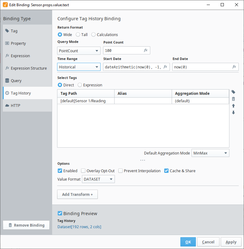

Tag History Binding​
Tag History bindings allow you to pull Tag History data that is stored in the database into a component through a binding.
Configuration PropertyDescription
Return FormatAllows you to select the return format of the data.
  • Wide: Every column is a different tag, and each row is their values at different times.
  • Tall: There are columns for Value, Quality, Timestamp, and Path, and each row is a new tag value at a specific time.
  • Calculations: Will perform a calculation on the returned data, and return the calculated values instead. For example, using the Average calculation will generate an average of each tags value over the time range selected.
Query ModeHow you want to query out the data.
  • PointCount: Will return the number of records defined in the Point Count property. Note that setting this property to -1 will retrieve pen data points as they are stored in the database. In other words, this is the same as setting the Query Mode to AsStored.
  • Periodic: Will return records separated by an amount of time specified in the Period property.
  • AsStored: Will return the records as stored in the database. While querying data with this mode, multiple value changes at the same timestamp will result in multiple rows, one row for each unique value.
Time RangeThe time range to pull data values from. See Time Range.

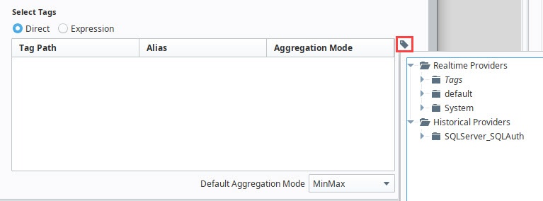

Select TagsAn area to select the tags to trend. Tag paths can be defined directly or using an expression. See Using Dynamic Tag Paths below about Expression mode.
New in 8.1.13
Users may now browse for and select tags from both Realtime and Historical Tag Providers.
Aggregation ModeThe aggregation mode that will be applied to each time slice, unless a more specific aggregation mode is defined on a tag path. For more information on how time slices are populated, see the How the Tag Historian System Works page. See Aggregation Mode.
Default Aggregation ModeAggregation mode to use as a default if the Select Tags are set to Default Aggregation mode.
OptionsAllows you to specify various options that will apply to the binding. See Options.

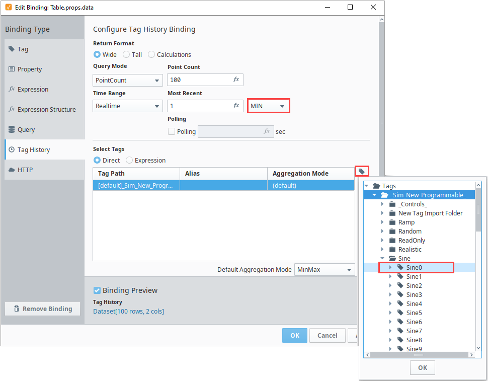

  1. Drag a Table component onto a view. Select the Table component.

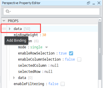

  2. In the Property Editor, click on the Binding icon next to the data property. The Edit Binding screen is displayed.
  3. Select Tag History as the binding type.
  4. In the Time Range section, select and the last 1 minute of data.
  5. Under the Select Tags section, click on the Tag icon. Navigate to the first Tag and click OK. Repeat for additional Tags. In our example, we chose the Sine0 and Sine2 Tags.
  6. Notice the Binding Preview at the bottom of the screen. Click OK to save the Tag History binding.

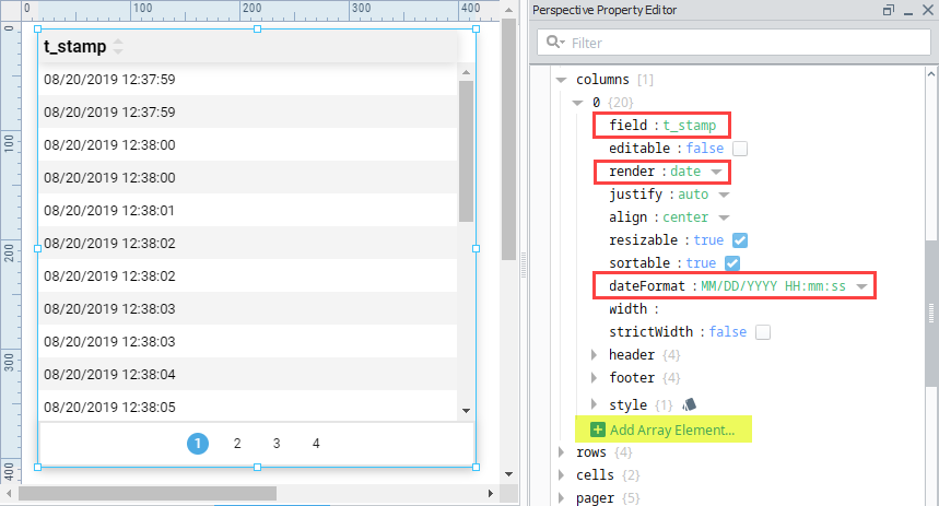

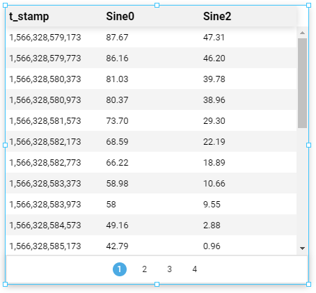

  7. Back in the view, the Table component now contains a column for the timestamp and one for each Tag. Notice how the timestamp does not have a date format.
  8. In order to change the t-stamp values into a date format, in the Property Editor under columns, click Add Array Element....
  9. You'll notice that once the Array Element is added, the other two columns (Sine0 and Sine2) disappeared. We'll add them back in Step 10.
    1. In the field property, enter t_stamp (which is the column name).
    2. For the render property, select date from the dropdown.
    3. Select a dateFormat from the dropdown. In this example, we used the date time format.
  10. Now, let's add the Sine0 and Sine2 columns back into our table by clicking on Add Array Elements... 2 times (refer to the yellow highlights in the image above). There is no need to change any of the Sine0 or Sine2 column properties unless you want to change the default settings or rearrange columns.
