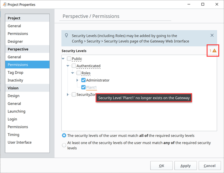

Deleted Security Level Indicators​
New in 8.1.25
Since security levels are set through the Gateway, it may not be immediately obvious in the Designer that a security level has been deleted. This can be checked by accessing the Project Properties window and navigating to Perspective > Permissions. In the example image below, the Plant1 role has been deleted. This is indicated by the security level, and any child levels, appearing grayed-out with a red warning underline. Hovering over the security level displays a tooltip informing the user the security level no longer exists on the Gateway. A warning indicator icon will also appear in the upper right-hand corner with the number of selected security levels that no longer exist. If you follow the security levels tree up to the parent levels, you'll notice affected levels include a dotted underline.
All warning indications are removed when deleted security levels are unchecked and new settings are saved. Additionally, the deleted security level will no longer be visible.
These security level indications are visible on the Event Configuration, Edit Permissions, and Tag Editor windows when applicable.
