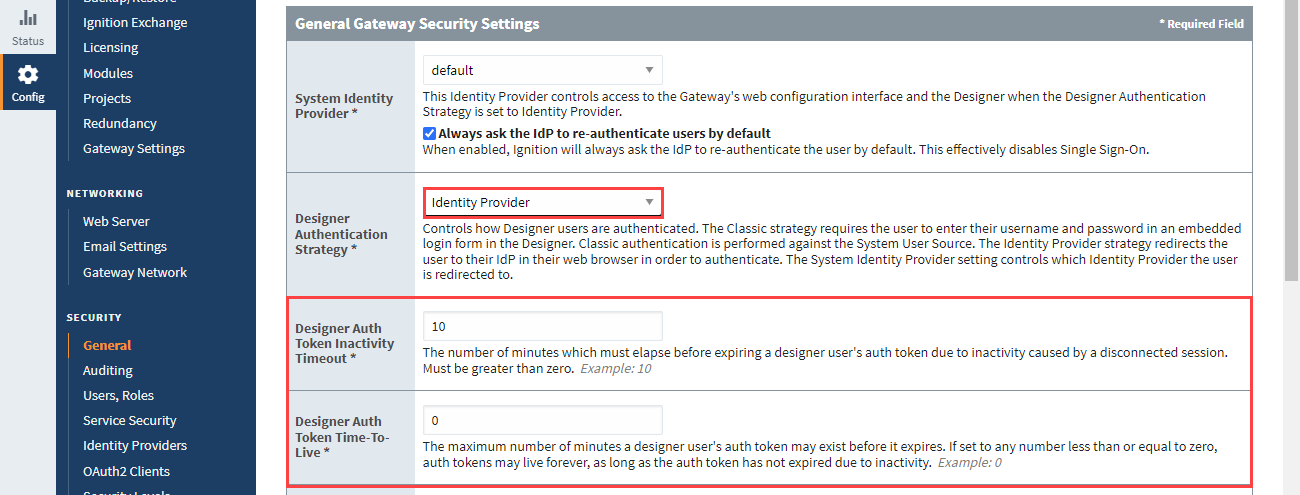

You can further configure auth tokens by adjusting settings that control the auth token lifecycle. To see these settings, make sure Identity Provider is selected as the Authentication Strategy as these settings do not apply to the Classic Authentication Strategy.
  • User Inactivity Timeout: The number of minutes which must elapse before expiring a user's auth token due to inactivity caused by a disconnected session. Must be greater than zero. Default: 10 minutes.
  • Time-To-Live (TTL): The maximum number of minutes a user's auth token may exist before it expires. If set to any number less than or equal to zero, auth tokens will not expire, as long as the auth token has not expired due to inactivity. Default: 0 minutes (does not expire).
For Designer Auth Tokens, these settings can be found on the Gateway General Security Settings page by navigating to Gateway > Config > Security > General.
For Vision Client auth tokens, these settings can be found in the Designer by opening the Project Menu, selecting Project Properties and navigating to Vision > Login.
