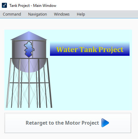

In this example, we have two projects (Tank and Motor) that we will set up to retarget to each other.
  1. On a blank window, add a Button component, and either change the button text or add a label that informs the user that the button retargets to a new project.
  2. Right-click on the Button and select the Scripting option.
  3. On the action > actionPerformed event, add the following script to the script builder:
    Python - Retargeting to Another Project
    # Retarget to another project on the same gateway.
    # This script can be run from any button in a project.
    system.util.retarget("My_Other_Project")
  4. Replace the My_Other_Project text with the name of the project you want to access. In this case, the script text was changed to Tank_Project for the Motor project to navigate to the Tank project when clicked.
  5. Click OK.
  6. Repeat steps 1-4 in the other project, the Tank project, replacing the Tank_Project script with Motor_Project. This can be repeated with more buttons and scripts that lead to other projects.
  7. Save your projects.
  8. Open the Client and select the Retarget buttons to navigate between the Tank project and Motor project.
    Tank ProjectMotor Project
