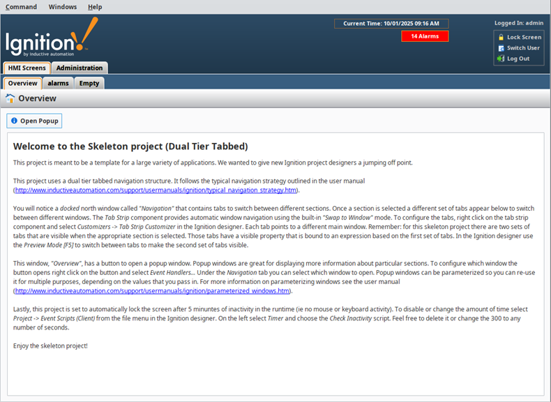

  • Tab Strip Navigation is a simple strategy used for small structures regardless of how organized your project is. It lends itself perfectly to only having a few windows and showing all of them on a navigation window. Having too many tabs does not work well with the Tab Strip because of size limitations. You want your users too see all the navigation tabs immediately on the first screen. The Tab Strip works by clicking to swap one main window for another.
  • Two Tier Navigation is similar to the Tab Strip, but is good for small and regular size project structures where windows are grouped. It contains a second level of tabs allowing you to navigate around various areas of your project. This strategy has a docked window that contains tabs that are always open to do navigation, and the main window which fills the rest of the space.

The most common mistake that will cause windows to stay open unintentionally is to implement a swapping navigation system using the system.nav.openWindow() function on main windows instead of swapTo. When you do this, the next time the swapTo function is called, it may swap from a window that is hidden behind the current 'Main' window and look like nothing happened. It is easy to check the client's Windows menu to see what windows are currently open. If there are more windows listed there than you can currently see, there is a problem in your navigation logic that is failing to close windows properly.
Swapping a Main Window with a Docked Window​
Another common mistake that will cause windows to stay open unintentionally is to implement a swapping navigation system using the system.nav.swapTo() function on windows that are docked. This will cause your docked windows to be 'swapped in' as a maximized window instead of its usual size. When you do this, the client will not see it as a main window and next time the swapTo function is called, it may not have space on screen to open the main window. Logging out and back in to the client (or restarting it) is the only solution to this. Identify the offending button or script that is swapping the docked window and change it accordingly.
