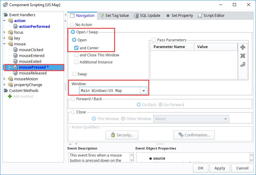

  7. Select the mousePressed event handler, and with the Navigation tab selected:
    1. Select the Open/Swap radio button.
    2. From the Window drop-down box, select the window that is your overview map.
    3. Click OK.
      Create Navigation Drill Down in Designer Step 7c
