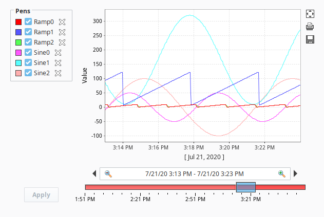

You can organize pens on the Easy Chart by creating custom names and groups for each pen. By default, when you drag Tags from the Tag Browser on to the Easy Chart component, the pen name is the same as the Tag name and organized into a single group called β€˜Pens.' One of the great things about pens is you can change pen names and organize pens into different groups making it easier for the operator to quickly analyze the data.

  5. Once you have all your pens configured, click OK. Operators will see the Pen and Group names organized into two legends on the Easy Chart. You can update the pen and group names on this view by double clicking on any of the fields. It’s a faster way to edit this information then having to go to the Edit icon for each pen.
    Tip for Viewing Specific Pen Values
    To see specific Pen values on the Easy Chart, uncheck the Pen and click the Apply button. To see all Pen values, make sure all Pens are checked, and hit the Apply button.
