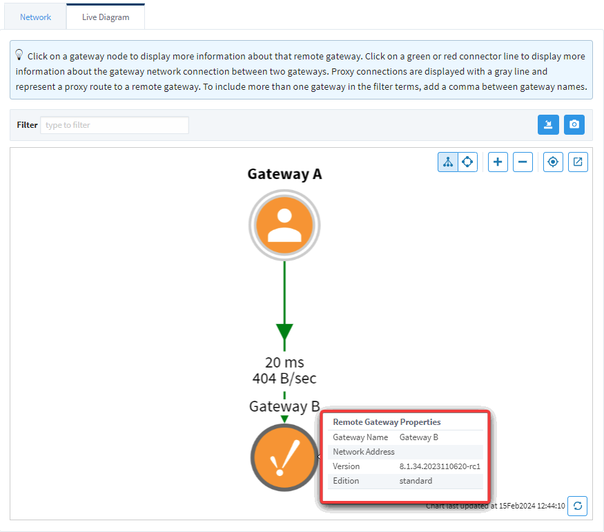

Gateway Nodes​
On the other hand, clicking on the Gateway node itself will display information such as:
  • Gateway Name
  • Network Address
  • Version
  • Edition
Gateway Nodes
note
If a Gateway in your Gateway Network is running Ignition version 8.1.24 or below, the Version and Edition fields will be N/A.

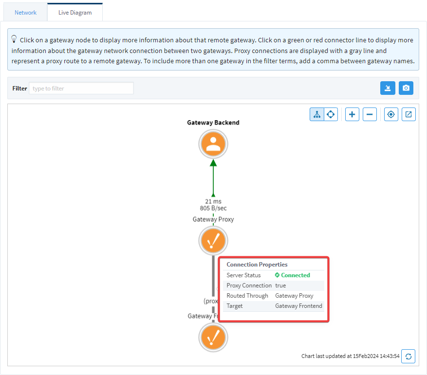

Proxy Connections​
The Gateway Network Diagram will also display proxy connections differently. Instead of a green arrow indicating status and direction, the connection will be grey with no direction indicator. Clicking on a proxy connection will give the following information:
  • The status of the server
  • Whether or not the two Gateways are using a Proxy connection
  • Which Gateway the proxy is routed through
  • The proxy connection's target Gateway
Proxy Connections
