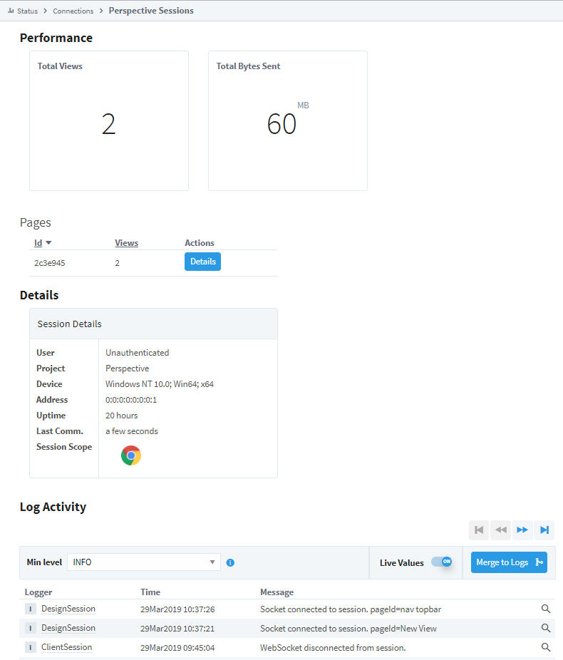

Perspective Session Details​
The Performance Page within the session displays more in depth information such as the Page Id and how many views are on each Page. Hit the Details button to get more detailed information about each page in the session.
Performance​
| Attributes | Description |
| Total Views | The number of currently active pages. |
| Total Bytes Sent | Displays total number of bytes sent out. |
Pages​
| Id | Page Id. |
| Views | Displays total number of views on a page. |
| Actions | Displays the details of the view instances in the session. |
Log Activity​
| Min level | Dropdown menu with options Info, Debug, and Trace. |
| Live Values | Toggle switch to turn live values on or off. |
| Merge to Logs | Merge the settings of the current view with the main Diagnostics Log Viewer. |
| Logger | Name of the logger that describes the context of the message. |
| Time | Time of log. |
| Message | Message for the log. |
| Displays log properties of the logged event. |
