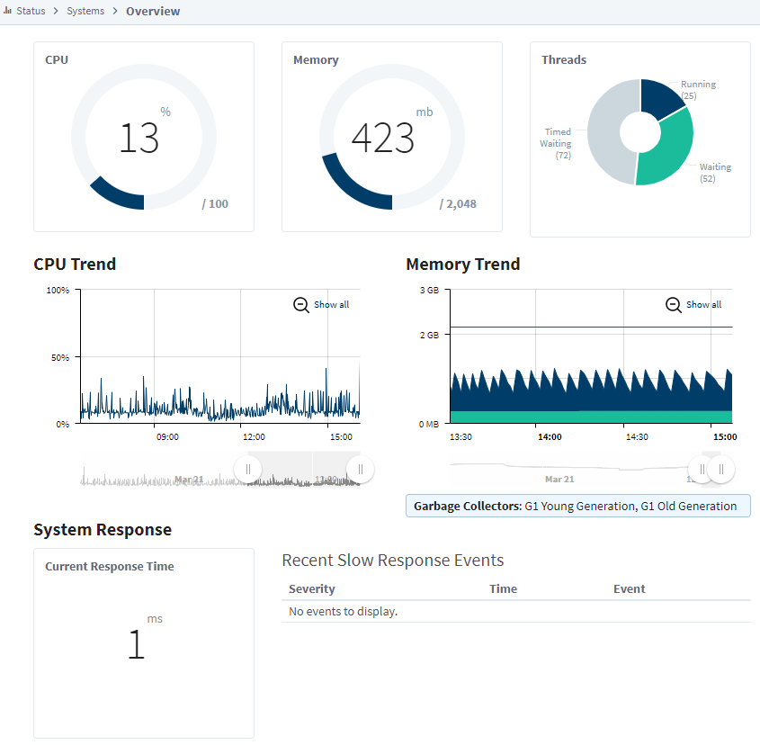

Performance​
The Performance page displays information on the resource usage of the Gateway. This page enables you to quickly assess your Gateway's overall health and determine if the Gateway is being taxed too heavily for the server it's running on. You can see the current CPU usage, the current memory usage (in megabytes) out of the total allocated for the Gateway, and how CPU threads are performing. In the CPU Trend and Memory Trend sections there are sliders you can move to set the time range anywhere with in the previous 24 hours. The lower portion of the page shows the current system response time as well as a log of any recent slow response events.
Gateway Status Page - Performance

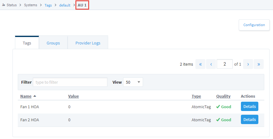

The details of the Tag Provider will show a list of all currently configured Tags in that Tag Provider, and show some basic information about them. You can browse through the Tag structure to get more information about each Tag. When clicking the Details button for an individual Tag, you will be brought to a Tag Diagnostics screen that will provide more detailed information about that particular Tag, such as if it has a script written in its Tag event scripts and what its last value was, among other information.
Gateway Status Page - Tag List
