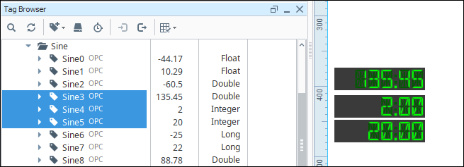

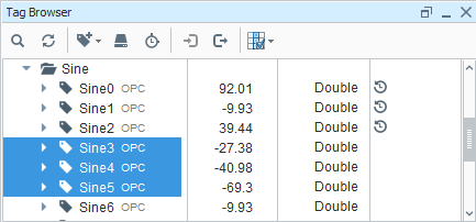

    1. Go to your Tag Browser, and select some tags you want to add to the Leased Tag Group. This example uses three Sine tags: Sine3, Sine4, and Sine5.

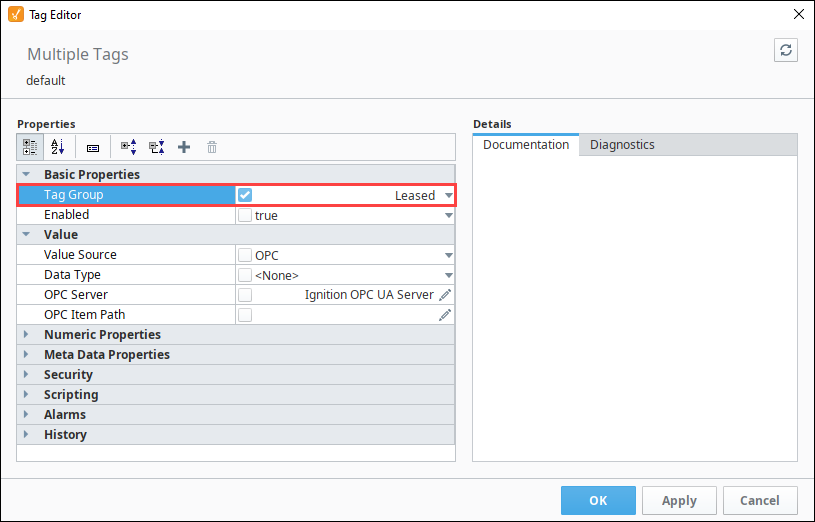

    2. Right click on the selected tags, and click on Edit tags.
  7. The Tag Editor will open showing you are editing multiple tags. From the Tag Group dropdown list, choose Leased, and click OK.
You just created a new Leased Tag Group and added some tags. These tags are only polled quickly when a component that is bound to it is showing in a Client, Session, or when the tags are showing in the Designer. For example, these three Sine tags that are part of the Leased Tag Group are each bound to an LED component.
