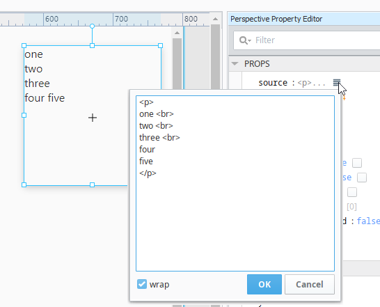

If you would like to manually add line breaks, the most direct approach would be to disable the escapeHTML property, and add your own paragraph and line break elements. Once disabled, you can add line breaks as seen below:
Value of sourceResult
<p>
one <br>
two <br>
three <br>
four
five
</p>
Because there isn't a line break between "four" and "five", they're on the same line.

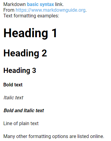

Example 1​
PropertyValue
props.sourceMARKDOWN source:
Markdown [basic syntax](https://www.markdownguide.org/basic-syntax) link.
From https://www.markdownguide.org.
Text formatting examples:
# Heading 1
## Heading 2
### Heading 3
Bold text
Italic text
Bold and Italic text
Line of plain text
Many other formatting options are listed online.

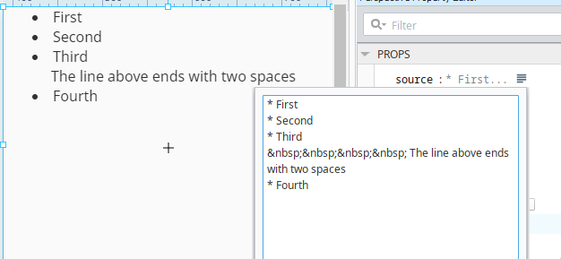

Example 2​
You can add additional lines within a list by ending the previous line with two spaces. In the example below, the text on the third line is actually "Third ". You can then force spaces via HTML using &nbsp;.
* First
* Second
* Third
&nbsp;&nbsp;&nbsp;&nbsp;The line above ends with two spaces
* Fourth

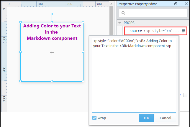

Example 3​
The following code was used in the example below and pasted into the source property of the Markdown component.
<p style="color:#AC00AC;"><B> Adding Color to your Text in the <BR>Markdown component </p
