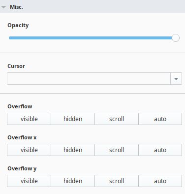

    Misc Menu​
    Property NameDescriptionExampleOutput
    OpacityDescribes the transparency level for a component, where 1 is not transparent at all, 0.5 is 50% see-through, and 0 is completely transparent. Opacity applies to text, border, and outline properties.opacity: 0.4Hello World
    CursorSpecifies the mouse cursor to be displayed when pointing over a component. For a full list of options, see the MDN documentation.cursor:pointer
    OverflowSpecifies what should happen if content overflows a component's box: whether to clip content or add scrollbars when a component's content is too big to fit in a specified area. For an description of each value, see the Overflow Property Table.overflow:scroll
    Lorem ipsum dolor sit amet, consectetur adipiscing elit. Praesent fringilla, mi nec ultrices auctor, metus ante
    Overflow XSpecifies whether to clip the content, add a scroll bar, or display overflow content of a block-level component, when it overflows at the left and right edges. For an description of each value, see the Overflow Property Table.N/AN/A
    Overflow YSpecifies whether to clip the content, add a scroll bar, or display overflow content of a block-level component, when it overflows at the top and bottom edges. For an description of each value, see the Overflow Property Table.N/AN/A
    Overflow Property Table​
    Below is an expaination of the various values for overflow properties. Additional details can be found in the MDN documentation.
    ValueDescriptionExample
    visibleThe overflow renders outside the component's box. It is not clipped. This is the default.
    hiddenThe overflow is clipped, and the rest of the content will be invisible.
    scrollThe overflow is clipped, but a scrollbar is added to see the rest of the content.
    autoIf overflow is clipped, a scrollbar will be added to see the rest of the content.
