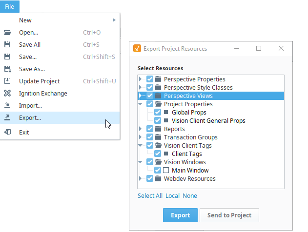

Export a Project from the Designer​
When making a project export from the Designer, you get to choose which project resources are added to the export file. The export does not include any Gateway resources. When restoring a project export in the Designer, you also get to choose which project resources are restored into the currently open project from the exported .zip file.
From the Designer, go to the top menubar, click on the File menu and select Export.
The Export screen will be displayed and you'll see a list of project resources to export. By default, local project resources are selected. Unselect any resources you don't want to include in the export. When exporting a project, there is a Send to Project button that allows you to directly send the project (or resources in a project) to another project on the same gateway. There is a local project export option, meaning only local (non-inherited) project resources are selected and will be exported.
Click Export.
This opens a Save dialog window. Select a folder and click Save.
This export of the project can be imported to any other instance of Ignition that is running the same version or later.
