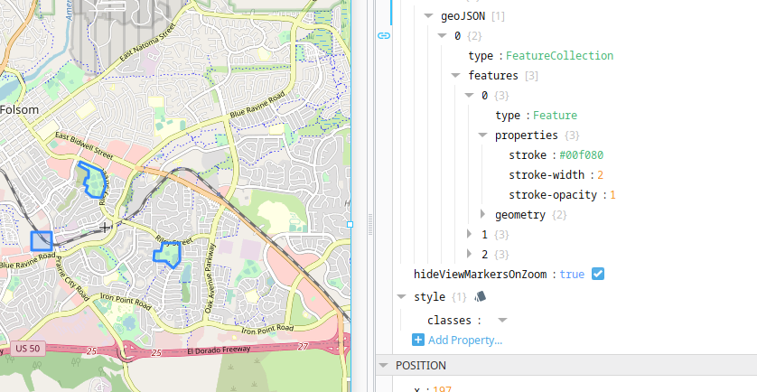

Pass the Data to the Map​
Now that we have some data we can hand it off to our map component. We'll use a HTTP binding.
  1. In the Designer, navigate to, or create, a Perspective view.
  2. On the view, create a Map component.
  3. With the Map selected, locate the props.layers.other.geoJSON property. Click the Add Array Element button, which adds a "0" member.
  4. Configure a binding on the "0" member.
  5. Select HTTP as the binding type.
  6. For the URL property, enter the endpoint housing your data. If you're using a Web Dev resource as demonstrated earlier on this page then you can copy the mounted path from the Project Browser, but make sure to use a full URL by adding in "http://" or "https://".
  7. After pasting the URL, place quotation marks on both sides of the URL, as the field expects a valid expression.
  8. Click OK to close the binding window.
Now we have some features on our map that are driven by our geoJSON data.

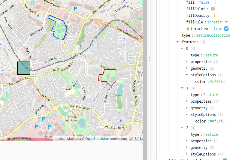

Update our Binding​
Now that our map is using the updated data, you should see that the "properties" object under each feature contains some styling properties. However, they are being ignored. This is because we need to add a "styleOptions" object in each feature, and relocate the styling configurations so they're under the new object.
In addition, we should also add a shared styleOptions object as a peer to all of our features. This allows each feature to only override the style settings they need to. In other words, we want something like this:
We can do this automatically with a Script Transform.
  1. Select the Map component.
  2. Locate the binding on props.layers.other.geoJSON.0, and click the link icon to open the binding window.
  3. Click the Add Transform button.
  4. Select "Script" and click Add Transform >.
  5. Locate the first line of editable code. Replace that with the code below.
    # Define a base style for all features, and add them as an object at the root of our results.
    # The keys below are based upon the expected keys that the Map component supports.
    value["styleOptions"] = {
    "stroke": True,
    "color": "",
    "weight": 2,
    "opacity": 1,
    "lineCap": "inherit",
    "lineJoin": "inherit",
    "dashArray": "",
    "dashOffset": "",
    "fill": False,
    "fillColor": "",
    "fillOpacity": 1,
    "fillRule": "inherit",
    "interactive": True
    #Here we iterate all of the features within our data.
    for i in value["features"]:
    # Inside each feature, we can examine each key in "properties", and add custom styling
    i["styleOptions"] = {}
    if i["properties"].has_key("stroke"):
    i["styleOptions"]["color"] = i["properties"]["stroke"]
    # Note that we need to both enable fill and specify the fill color if the feature has "fill"
    # under its raw properties key. This is because our base style above set "fill" to False.
    if i["properties"].has_key("fill"):
    i["styleOptions"]["fillColor"] = i["properties"]["fill"]
    i["styleOptions"]["fill"] = True
    # Here we also need to change "fill-opacity" to "fillOpacity", to match the map's default styleOptions keys.
    if i["properties"].has_key("fill-opacity"):
    i["styleOptions"]["fillOpacity"] = i["properties"]["fill-opacity"]
    return value
    note
    Make sure the code is properly indented after pasting. No visible characters should appear on the far left of any line.
  6. Click OK to close the binding window. Your features should now be using the updated styling data.
