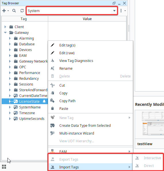

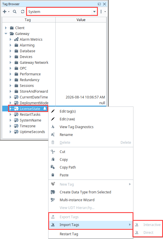

There may be instances where you want to export the configuration of a System Tag. Unlike regular tags from a Tag Provider however, the built-in import and export functionality is disabled for System Tags.

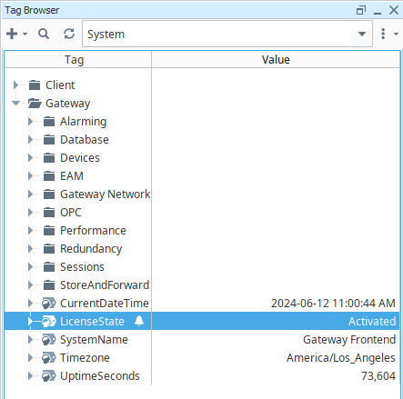

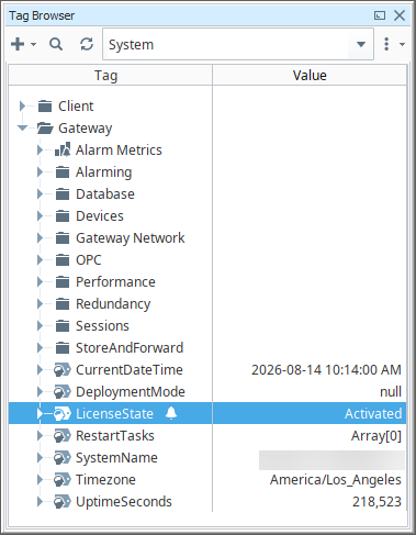

As a result, we will use both scripting and system functions to import or export the configurations we want. In each of the examples below, we have configured a single alarm on the LicenseState tag that we want to export and import to another Gateway, located in the Tag Browser under [System] > Gateway > LicenseState.

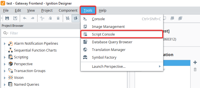

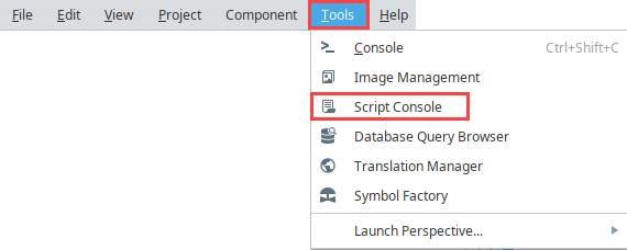

Open the Script Console in the Ignition Designer.

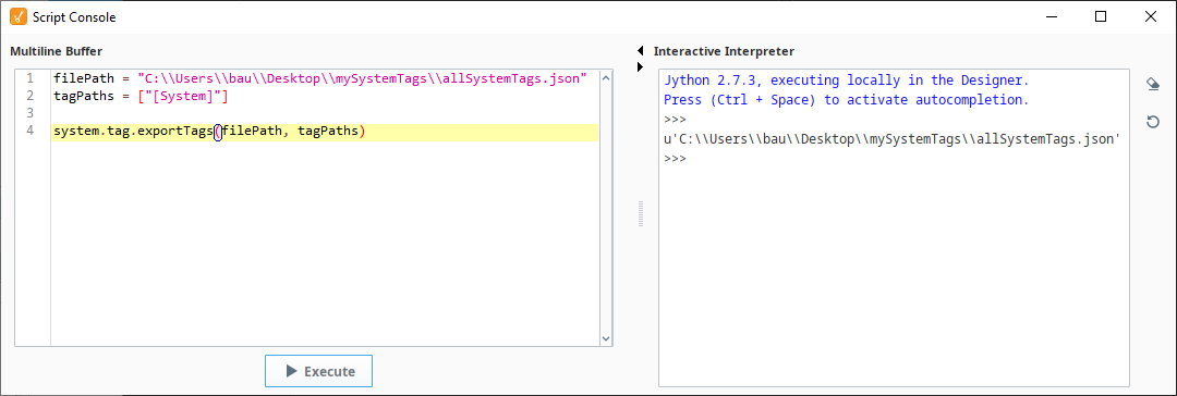

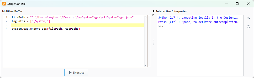

Use the system.tag.exportTags() function to export your System Tags. We can use the following script, replacing the
filePathparameter with the filePath you want to export to:Export System Tags ScriptfilePath = "C:\\Users\\bau\\Desktop\\mySystemTags\\allSystemTags.json"
tagPaths = ["[System]"]
system.tag.exportTags(filePath, tagPaths)
You should now have a file containing your tags in JSON called allSystemTags.json, located at the specified file path.

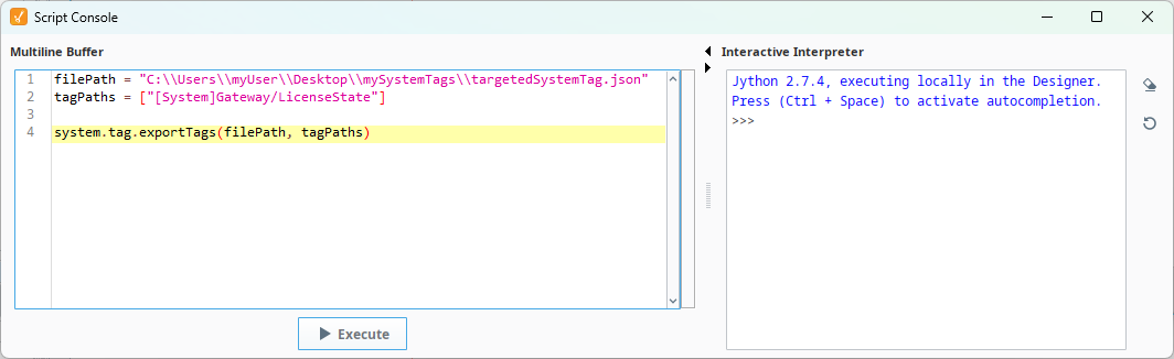

Exporting a Targeted System Tag​

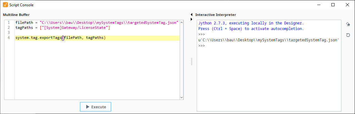

Alternatively, you can export a single targeted System Tag or group of System Tags. In the example below, we will export the LicenseState tag only, since this is the only System Tag that has the alarm we want.
Use the system.tag.exportTags() function to export the LicenseState System Tag. We can use the following script, replacing the
filePathparameter with the filePath you want to export to:Export LicenseState Tag ScriptfilePath = "C:\\Users\\bau\\Desktop\\mySystemTags\\targetedSystemTag.json"
tagPaths = ["[System]Gateway/LicenseState"]
You should now have a file containing the LicenseState tag in JSON called targetedSystemTag.json, located at the specified file path.

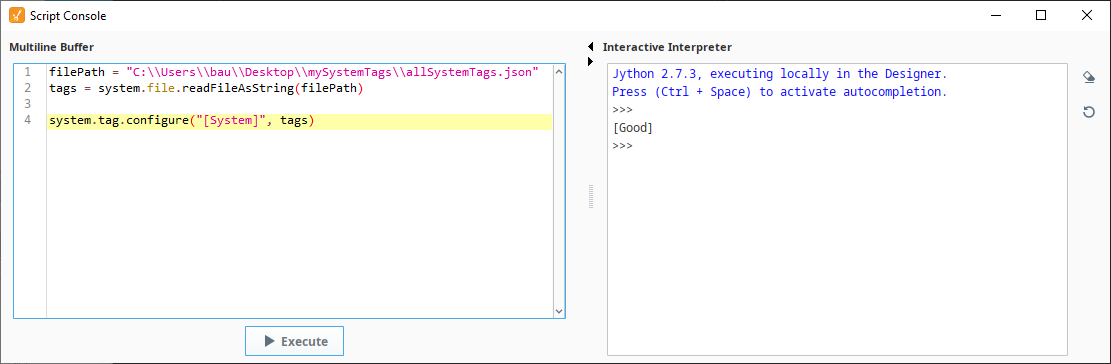

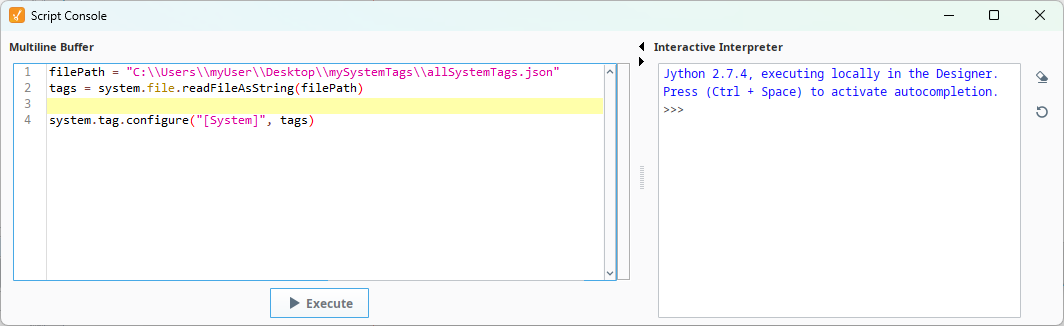

Use the system.tag.configure() function to import the allSystemTags.json file. We can use the following script, replacing the
filePathparameter with the path your .json file is located at:Import allSystemTags.json File ScriptfilePath = "C:\\Users\\bau\\Desktop\\mySystemTags\\allSystemTags.json"
tags = system.file.readFileAsString(filePath)
system.tag.configure("[System]", tags)
Your System Tags should now be updated with the imported System Tags' configurations.

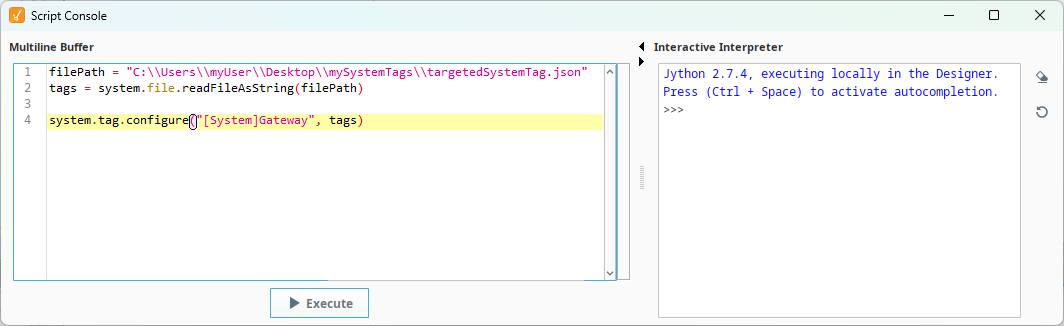

Importing a Targeted System Tag​
The steps below demonstrate how to import configurations for a single, targeted System Tag. In this section, we are assuming the targetedSystemTag.json file from the Exporting a Targeted System Tag example is accessible locally on the system importing the System Tag configuration, and inside a folder called mySystemTags.

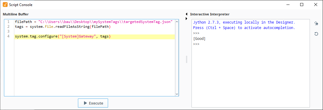

Use the system.tag.configure() function to import the targetedSystemTag.json file. We can use the following script, replacing the
filePathparameter with the path your .json file is located at:Import targetedSystemTag.json File ScriptfilePath = "C:\\Users\\bau\\Desktop\\mySystemTags\\targetedSystemTag.json"
# Note that unlike the previous example where we imported all the System Tags to the [System] provider,
# we need to specify the exact directory where our targeted tag lives.
system.tag.configure("[System]Gateway", tags)
The specified System Tag should now be updated with the imported System Tag's configurations.
