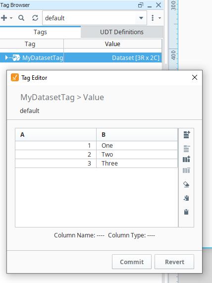

Example 4: Styling Rows - Dataset Data​
You can also change the color of rows in a table when the source of data is a dataset. This approach involves recreating the original data as a new JSON document that contains a style object for each row.
For example, say there's a memory tag set to a dataset type, which contains the following data:
AB
1One
2Two
3Three
Tag's JSON structure
