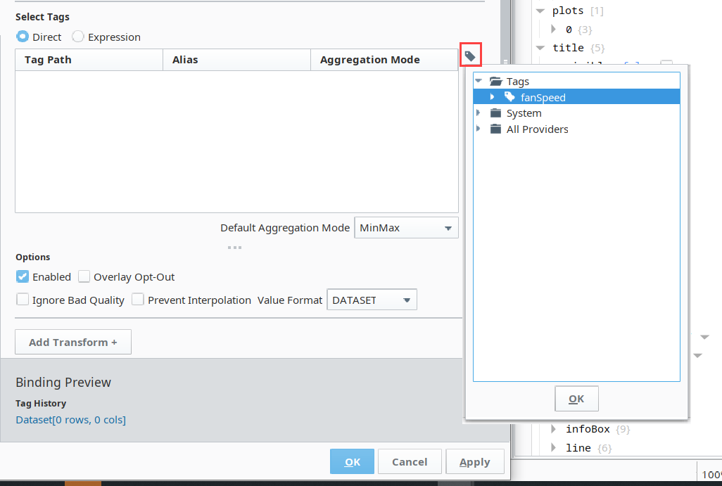

    8. Under the Select Tags section, click on the Tag " " icon and use the Tag browser to drill down to the Tag you created in Step 1
    9. Click OK.
    10. Click OK on the Binding Editor window to accept the binding changes. You should now have a Chart Range Selector displaying the last 1 hour of historical data for your Tag created in Step 1.

    16. For the Tag History Binding configuration, click on the Tag " " icon on the right of the Select Tags table and drill down to the Tag from Step 1, then click OK.
    17. After clicking OK and accepting the binding configurations on the Time Series Chart, you will be able to use your Chart Range Selector to select what data you want on your Time Series Chart to display. Simply drag and re-size the Chart Range Selector's brush section as shown below.
