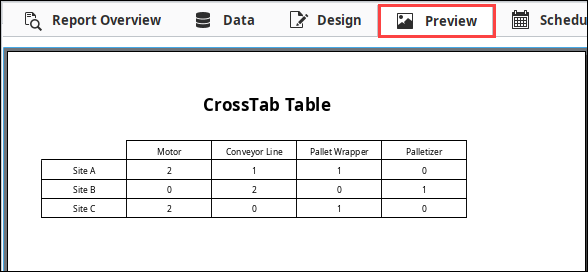

The objective of this CrossTab example is to show the number downtime time events by site and equipment. Let's give it a try!
  1. In the Data panel, create a CSV data source named Downtime_by_Site. You can copy the data from the Code Block below to create your own CSV Data Source.
    Downtime_by_Site
    Downtime_By_Site
    Equipment,Time,Site
    Motor,15,Site A
    Motor,23,Site A
    Conveyor Line,148,Site B
    Pallet Wrapper,58,Site A
    Motor,96,Site C
    Conveyor Line, 23, Site B
    Palletizer,40,Site B
    Conveyor Line,56,Site A
    Pallet Wrapper,45,Site C
    Motor,43,Site C
    CSV Data Source
  2. In the Design panel, drag a CrossTab component to your report.
  3. With the CrossTab component still selected, drag-and-drop your Data Key (i.e., Downtime by Site) from the Key Browser to the Data Key property in the Property Inspector.
  4. In the Key Browser, set the Show Calculations property to true.
  5. Next, add some data keys to the cells in the CrossTab Table component. From the Key Browser, drag the '@Equipment@' to the top cell, '@Site@' to the leftmost cell, and '@count@' to the remaining cell. This will show the downtime count of each piece of equipment by site.
  6. Switch to the Preview panel and your CrossTab Table will display the results.
