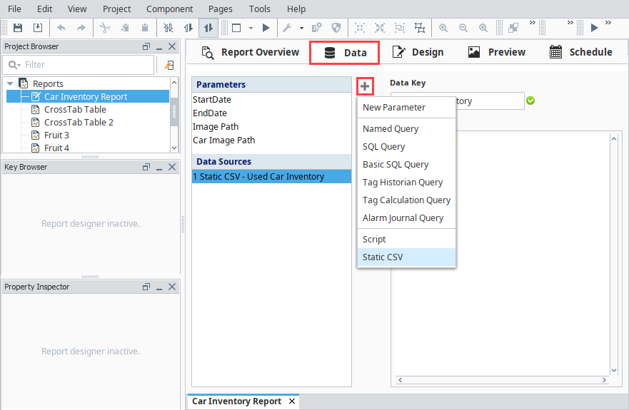

Data Tab​
The Data tab is the first stop for configuring a new report. You'll notice the list on the left that has labels for Parameters and Data Sources, as well as some buttons. On this page you can generate data that you want to make available on your report. Click the Add icon to see a list of built-in Data Sources and Parameters. Selecting any one of them will open the configuration screen for that Data Source type and enable you to start configuring the data for your report.
