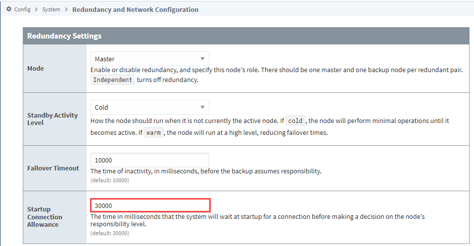

Ignition Versions Prior to 8.1.17​
If upgrading version 8.1.0-8.1.16, following the recommended process above will still successfully upgrade your system, but based on how you resume your Master control, you may have duplicated data from the slight overlap of having both Gateways up. Alternatively, you can use the following procedure to upgrade without disrupting your redundancy setup:
- Navigate to Status > System > Redundancy on your Master Gateway.
- Select Force Failover to set your Backup as your active Gateway.
- Navigate to Config > System > Redundancy on your Master Gateway.
- Adjust the Startup Connection Allowance setting to a large number. This will allow the Master to sit in the undecided state and not become active after being upgraded. Note the original value so you can reset it at the end of this process.
- Upgrade and start your Master Gateway.
- Wait for the Master to fully initialize and become ready to take back over.
- Shut down your Backup Gateway.
- Change the Mode setting to Independent.
- Change the Startup Connection Allowance setting to 0.
- Select Save Changes.
- Select Confirm.
- Now, change the Mode setting back to Master.
- Select Confirm.
- Upgrade your Backup Gateway.
- After the upgrade is complete, verify your Backup Gateway is connected and your redundancy is active.
- Return the Startup Connection Allowance setting to the original value.
